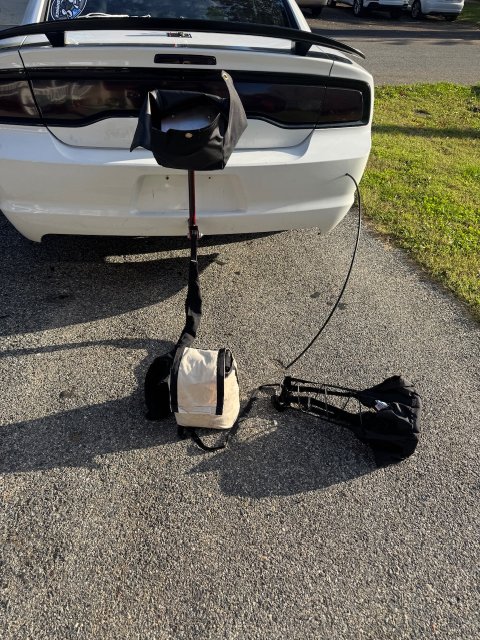

I may make a baby pass soon.

For some reason had to upload this three times…

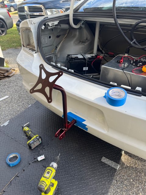

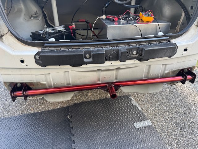

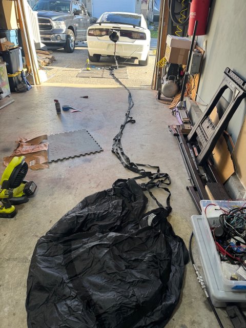

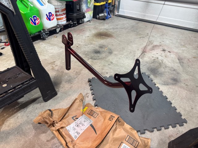

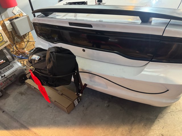

spraycan metallic red is my new favorite
Chute mount is from Tim at MAF
https://mafracing.com/products/challenger-parachute-mount-15-24
I am a Charger so some r&d to see if it would even fit. Expensive gamble if it didn’t 😂
It fits way better on the charger than the challenger. Hellcat tax still stings though will never understand why same fabrication parts are hundreds cheaper for mustangs

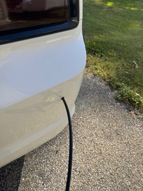

Is that teflon tape?
I use Loctite 567 for anything that's going to have pressure or fluids behind it. (Nitrous, oil, brake, etc.) The only time I use Teflon tape is on my wife's gardening equipment.
