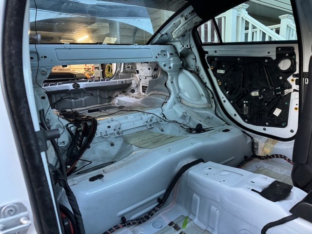

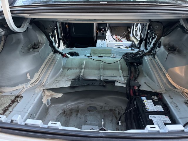

For what it is, it is extremely light.
Found some very unsavory items, promptly poured gasoline into glass bowl, dropped item into bowl let it dissolve, tossed onto scrap wood and burnt it. Promptly ripped off gloves after washed hands and face and took a shower. Iykyk but maybe I should spray the car with narcan 😂

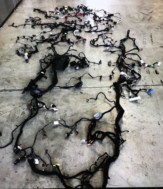

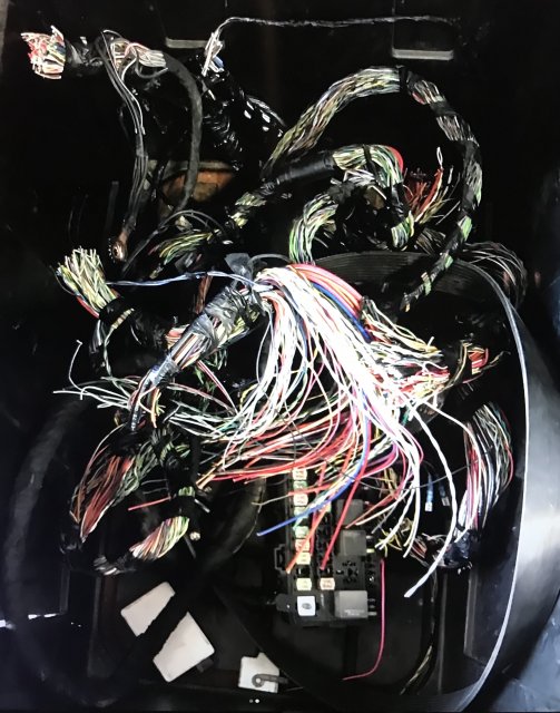

When those wiring harnesses look like this… you’re getting started 😬 3E00E49C-9B2B-4DF0-B0F4-3FA8B9618A10.jpeg FCFBBC4A-6FF0-4CC4-83D0-A5706C5733AE.jpeg

I’ve been through this before. It’s insane how many wire harnesses/“jumper” harnesses are in the car and how much they weigh

My Challenger was 80 lbs.

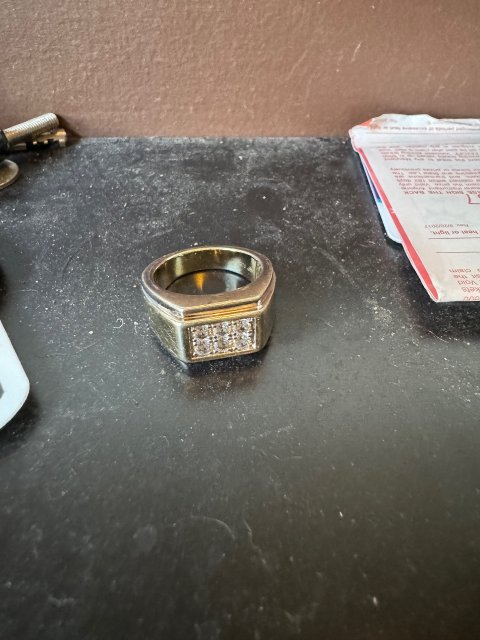

That’s where my pinky ring went!

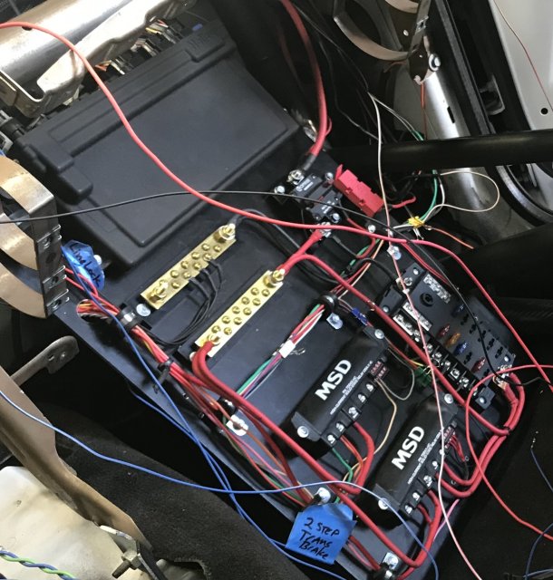

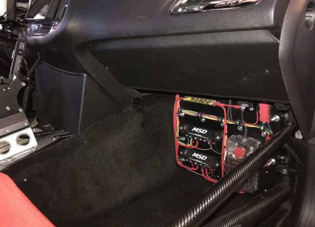

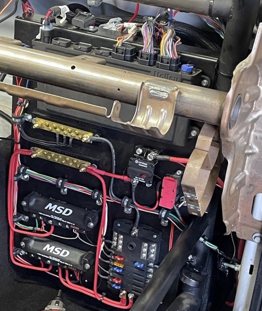

Your list of stuff all sounds good and I agree with everything you’ve got going on there. One thing to do with your harness when all that is being removed….. keep the connectors for what you’ll want to reuse for stuff like headlights and taillights. You don’t want to be trying to identify those when it’s all in a pile. Best to snip those wires leaving the connectors in place. The ECU and all of the relays and stuff are best placed together on a board where everything can be laid out and accessed. A couple pics of mine. All solid state and placed on the passenger side where the Holley harnesses can pass through the firewall in one place. We left enough length with the harnesses to disconnect the board and pull it back onto the floor to access the computer when necessary. 5C91893A-ED17-4D60-86D2-250E0F0BDEC9.jpeg E18B7FD1-75AA-403E-90AF-8A3894F1B274.jpeg 614C095F-9E2B-4DB8-9580-7698F16315DD.jpeg D138856B-3402-4F7D-A856-BBF1FA09543E.jpeg

@Marc W Goals! Lets see if I can get there.

Man I need a new job lol. @Marc W your car is a work of art. So clean

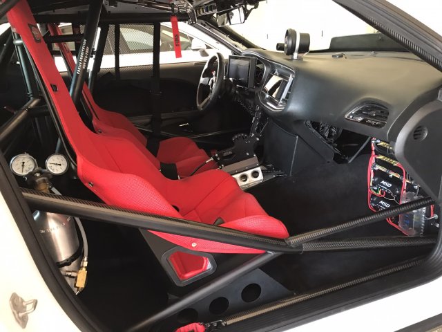

Thank you. That’s the way we roll 😎. I could loose some weight ditching all that interior stuff but…. Fk it. We’ll just make more hp 😂
