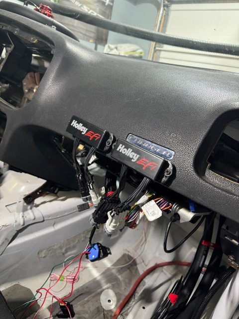

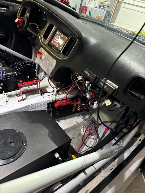

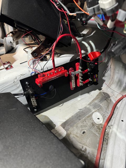

Taking a break from the fuel system setup. Getting back to the electronics.

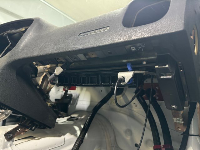

@HolleyPerformance #dominator mounted!
Its my dash I can drill as many holes as I want into it 😂

Would have put it elsewhere. I'd get sick drilling holes in my dash.
Like where, considering I sat there thinking for two hours. Let me know your solution?
3,633
11,722
I would put a CF plate there and attach them to that instead of individually to the dash. CF looks professional 👊😆

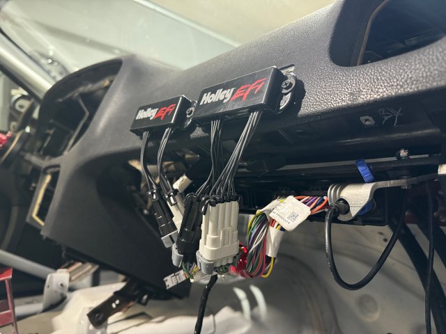

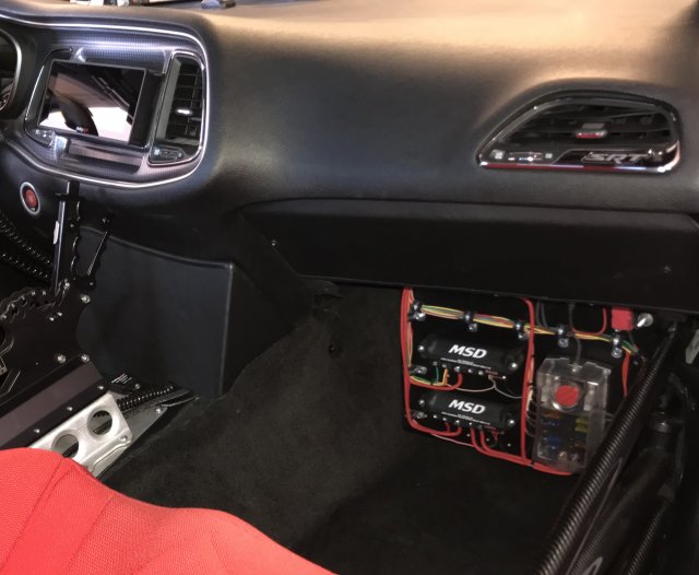

Under the dash on a bracket?
4,143
10,433
Thread Starter #533

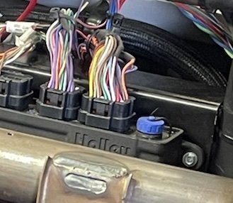

Oh sweet summer child. You think I wouldn’t have tried that?
The unfortunate part of the Hemi harness from Holley is there is no slack in the ignition modules… aka…
the plugs cannot be moved
62,447
218,522
Explains why so many race cars have wiring all over the interior

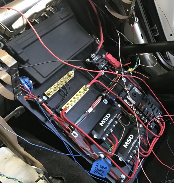

We placed all of the hardware on a panel with the ecu at the top and the plugs facing up. The harnesses have enough slack that the panel can be unbolted and moved to the floor to access everything. On the Magnum, the panel is placed horizontal behind the glove box opening with the ecu at the rear. It can be pulled out like a tray for access. Basically it’s a race car and you can do whatever works. Personally…. I dont think any two should be the same 😎 IMG_3975.jpeg IMG_8313.jpeg IMG_4998.jpeg

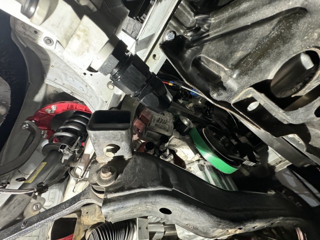

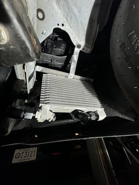

Little preview, fabbing my own mount for the hellcat oil cooler.
