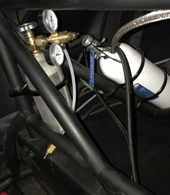

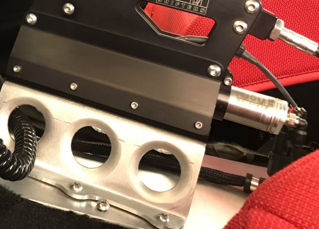

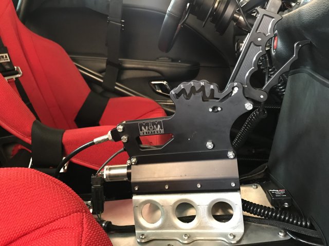

CO2. You can see it sticking out of the lower part of the shifter at the rear. With that Dominator you can pick your rpm and let it do it perfect every time. I don’t even have to think about it. View attachment 133554 IMG_4961.jpeg

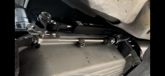

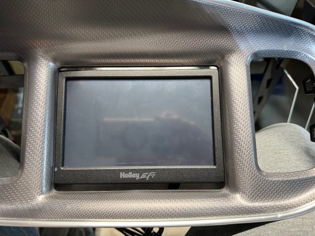

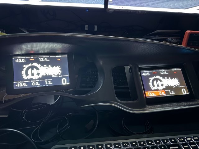

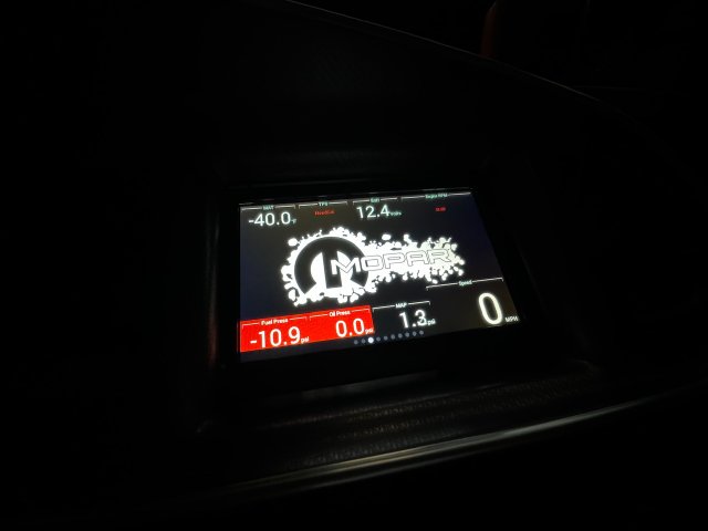

Through a very generous person I now have a wild fuel system going in my car. More on this as it happens. The drivetrain is almost done. Now its onto engine and electronics. In the meantime Ive gotten very intimate with Holley, themes and logging. My logging will be activated as soon as the car is in first gear… well how will the Dominator know what gear Im in…
motion raceworks to the rescue.
Not one but two screens…

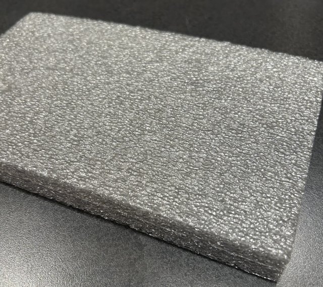

Very nice! I’m using some of the hard foam that comes as protective packing for some of the parts we buy. The Holley digital screens are one example. Easy to cut and squeeze into open spaces like that. Clean , lightweight way to fill spaces like that. I don’t have picture of it in the car but I still have a piece. IMG_6425.jpeg

Very nice! I’m using some of the hard foam that comes as protective packing for some of the parts we buy. The Holley digital screens are one example. Easy to cut and squeeze into open spaces like that. Clean , lightweight way to fill spaces like that. I don’t have picture of it in the car but I still have a piece. View attachment 135123
I have a few sheets of that stuff between the screens and the dominator, this is a good idea. Also for anyone doing solid metal to Holley mounts, I am using a rubber washer as well to absorb impact and keep metal off the Holley screens so they don't have friction marks.

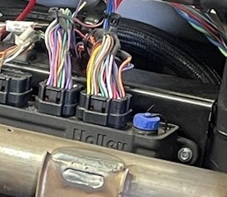

Speaking of your Dominator …. Go to Motion Raceworks and search for their Dominator Cable Saver. It’s a $20 device that protects the cable connection where the data cable plugs in. That cable is something that will stay plugged in and if it ever accidentally gets snagged or pulled on, it will break that plastic connector. That will require sending it back to Holley for repair. The plug with the blue cap…. IMG_8313.jpeg

Speaking of your Dominator …. Go to Motion Raceworks and search for their Dominator Cable Saver. It’s a $20 device that protects the cable connection where the data cable plugs in. That cable is something that will stay plugged in and if it ever accidentally gets snagged or pulled on, it will break that plastic connector. That will require sending it back to Holley for repair. The plug with the blue cap…. View attachment 135149
Where is yours 😂
3,609
11,632
I can’t find the picture. Probably one in my build. You should look thru all the pics. 😜

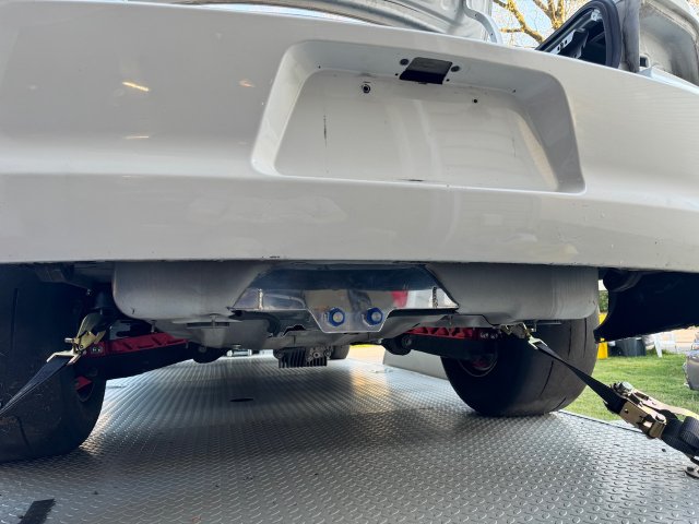

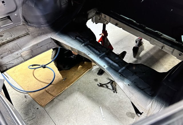

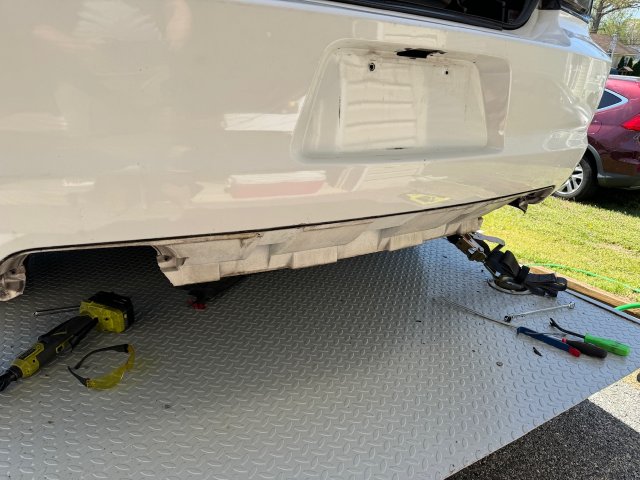

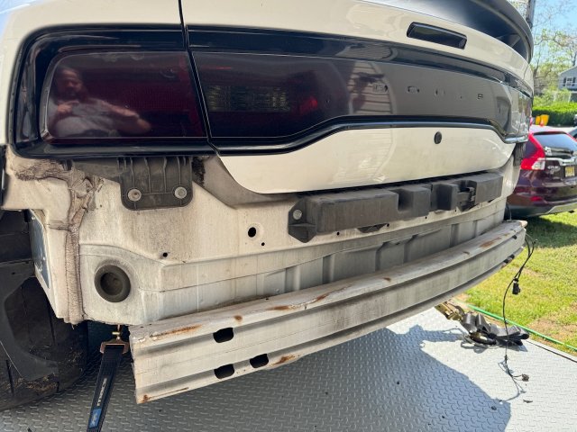

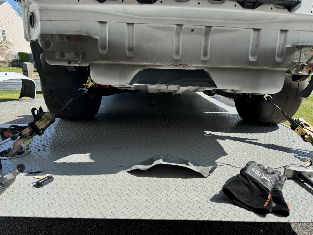

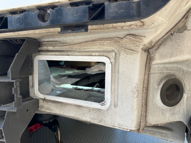

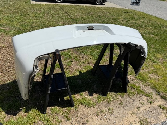

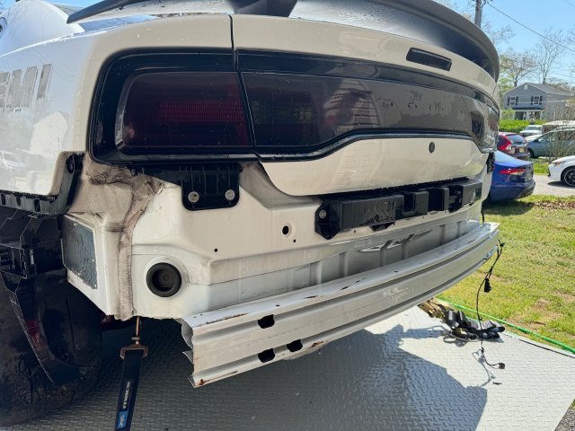

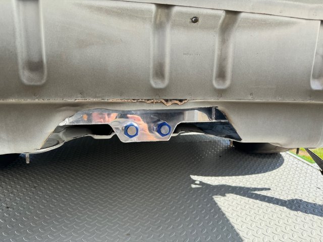

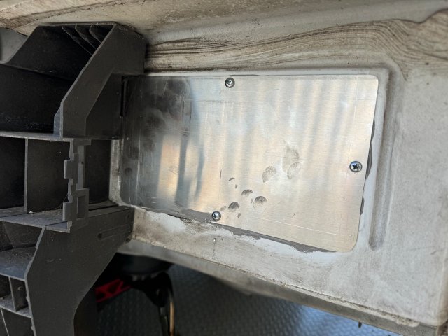

Relaxing Sunday project. Also learned I don’t like 4043 aluminum rod for welding. Here we go.
Removed black plastic crap
Cut off white plastic
Filled in these vent holes
Cleanest its been in 14 years
cuts and fitment
Final temp product

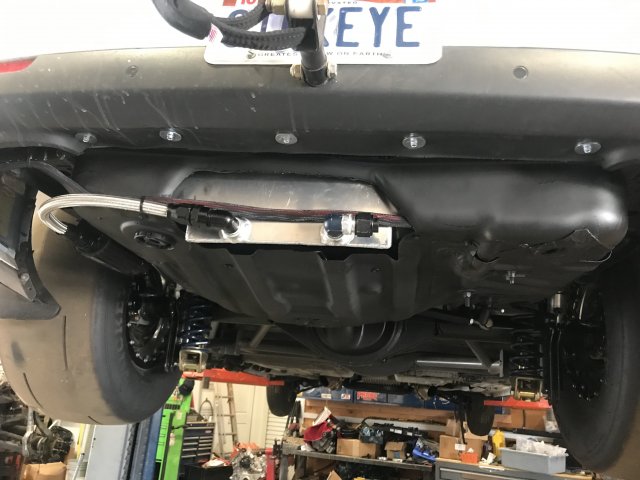

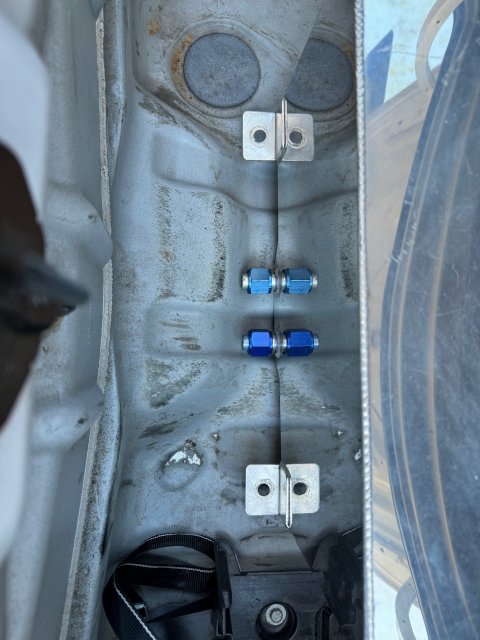

for some reason I could not weld a L bracket to the tank. I was blasting it with 160 amps on 30/70 at 90hz and it wasnt having it. Welding coach says ditch 4043 rod and use 5356. Says the silica content is less and wont look like pepper if overheated. TBD if it needs to go up in height. @Marc W has a similar cut out.
4,048
10,117
Thread Starter #398
What I modeled it after
3,609
11,632
Can’t be mine. Mine doesn’t have anything back there. Absolutely nothing 😂 IMG_6433.jpeg
