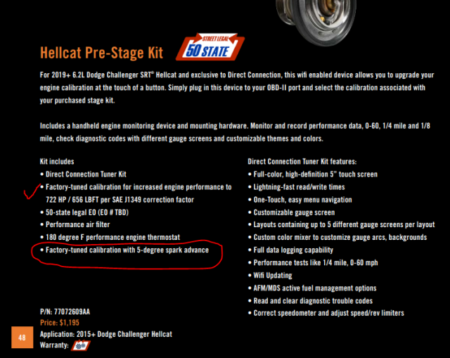

Also the part circled in red makes ZERO sense especially for the "pre stage" kit. It says you pick up a measly 5HP but then says it's a factory tuned cal with 5 deg spark advance?? What's that mean? 5 deg on top of a normal cal would net over 50RWHP and it's not possible to do that on pump gas anyway. When you finally step up to a pulley you get 40HP for over $2,000 BEFORE install charges to keep that precious warranty. 40HP wouldn't be worth it for me. If I'm going in there I want 100+.

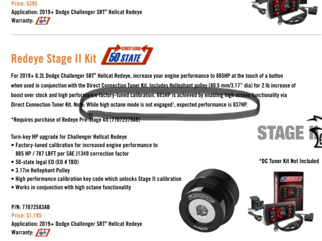

The biggest negative takeaway for me is that both Stage 1 & 2 upgrade packages require 100-octane unleaded - right?
For Redeye YES to get the advertised power, but it will run on pump gas at a lower power output. Another oddity is that Stage I for RE says 840 but required HO fuel. Then Stage II adds a pulley for 2 more pounds of boost for 885 on HO but says it'll run at 837 when not in HO mode but on 2 more psi of boost so WTH? So which is it LOL?
Honestly the RE Stage II looks like the most bang for the buck for this stuff but if going that route I'd still get a known good tuner setup for E85 and call it done and make 50-70 more HP on top of 885 and do flex fuel to boot.
Doesn't appear there's a Stage II for standard Hellcat that I saw so 40HP not really worth it IMO.
Can you imagine all the folks that don't know about this forum just running to the dealership blindly throwing the money LOL.

Just saw this....the last sentence is a good thing so they are going to take advantage of the way some of the Demon HO stuff works, and drop out of HO mode if knock is detected, but that first sentence is the "out" as it were.
@DGatzby you don't get 840 on 93 sir. 100 octane required assuming you're talking about these Stage kits.
Don’t we get the 838 stage two with the increased boost?

Smart to not be one of the early adopters on this I think. Hopefully the calibrations get out in the wild so some of us can take a look to see what's really being done. If they're bumping timing for more power while also increasing knock sensitivity to @Demoniccat earlier point, the vehicle could actually make less power than stock and perform worse. Who knows but all the strange contradictions in the catalog worry me.
"Maybe"? but I'd be REAL leery of running that on 93 personally especially for what you do with the car. The pulley brings you to 16.5 PSI of boost and that's a lot for pump gas in one of these. Mine makes 17 on the 2.72 and remember how that was never recommended for pump gas. I don't hammer it on 93.
837, 838, 840 WTF among friends, close. Let’s see if this is not some conservative number under the proverbial 840 hp high octane Demon Tune. Interesting it takes a Demon 100 octane to do this, but a potential tune for a RE is the same on “pump” gas.
I don’t know, thanks and we shall see what they have. Very interesting numbers especially if that is the combo that failed for you. As you know, just a bit of a exhaust plug up made mine not like itself.
