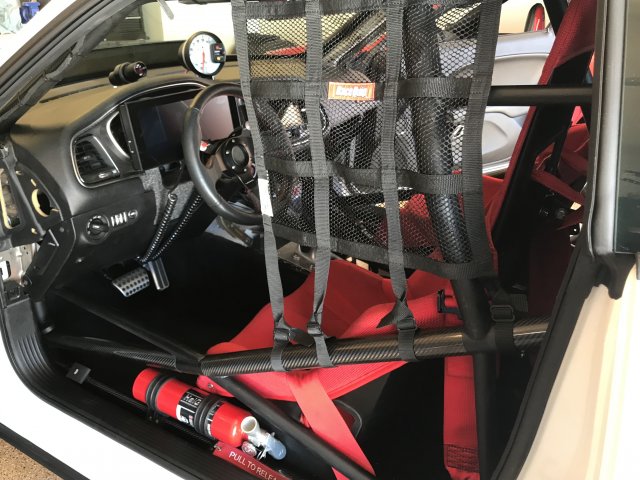

3,631
11,716
You still have the dash?
Of coarse…. It’s a street car 💁🏻‍♂️

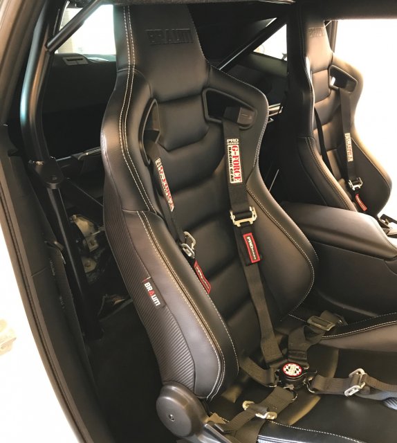

I’ll say this (again). A properly designed and fitted 8.5 cert cage is very streetable. Safety considerations are…. You need a harness that is tight enough while driving that you can’t hit your head on the bar that runs overhead at the door. The side curtain airbag isn’t going to function so you have sacrificed that level of safety. But…. older cars (consider you’re cruising in your ‘69 Hemi Roadrunner) don’t have have that either. It’s a matter of personal choice. To say it’s too dangerous to drive on the street means that all of your classic cars are too. Better not get in one of those. Here’s a picture of mine back in the day with the removable door bars out This cage was NHRA Certed for 8.5 seconds 2E3BA77F-A478-46C7-8A24-BDA86C2183E3.jpeg

It was crazy watching all of the cars with funny car cages cruising during Sick Week. Many you couldn't even see the driver they were behind the B pillar.

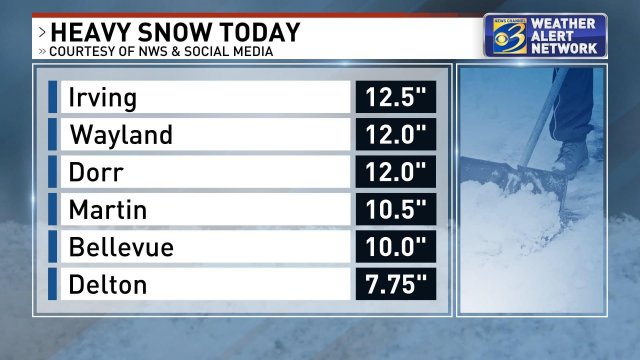

I guess no reason to be in a rush. Snow fall last night
