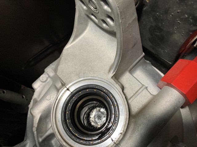

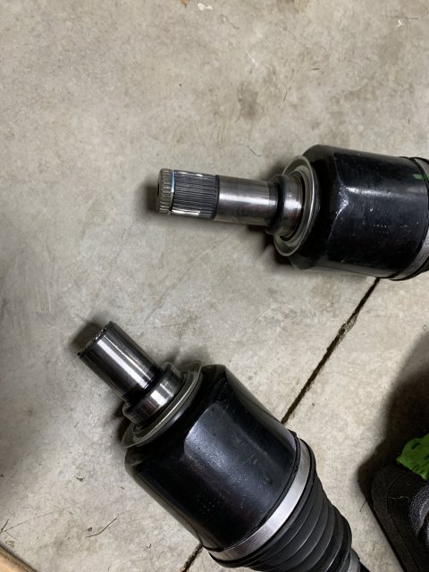

Things are interesting axle broke in the diff turns out so.. getting that out will be interesting
