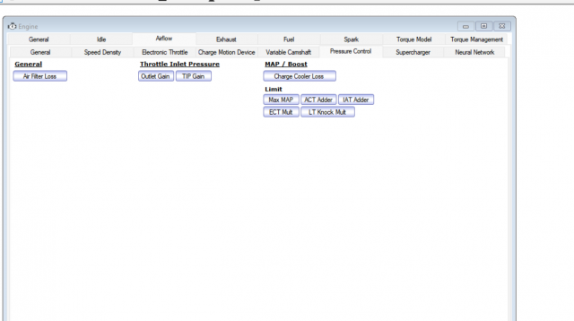

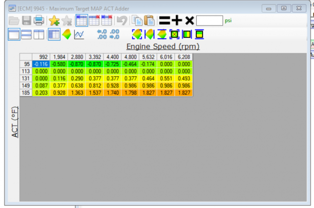

So another table I think goes forgotten about is this one.

Where is that one? I don't see it on mine.

Ah, on my 2016 that table is zero'd out.
