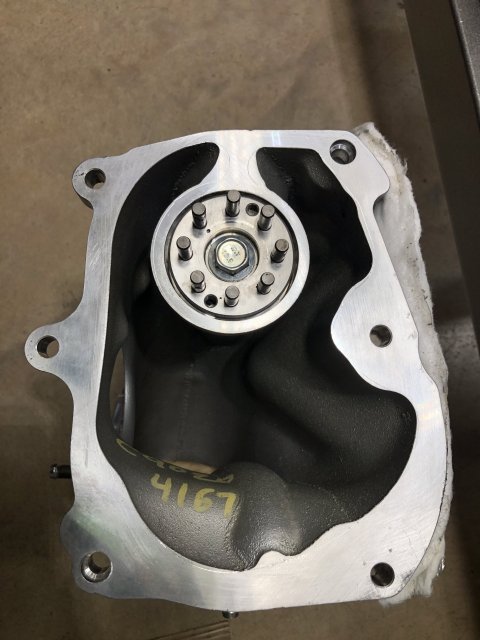

Here’s a before and after for you guys. Dyno’d 2/17 before adding a FAS Billet plate to my 2.4 IHI blower, avg 3 pulls 806 hp. Installed FAS Billet inlet plate, hand port matched my snout with a 2.85 Litens already attached, bolted on a Fastman 95 mm TB, no relearn no tune change, didn’t even disconnect the battery, picked up a solid 50 HP and 20 ft lbs TQ. Added 3 MPH to the top of my 1/4 mile time.

The snout inlet is 95.20 mm ID, the FM TB was a smooth transition to the snout as it’s 95mm. I just aligned it smooth with the inside of the snout and tightened the 4 TB to snout bolts.

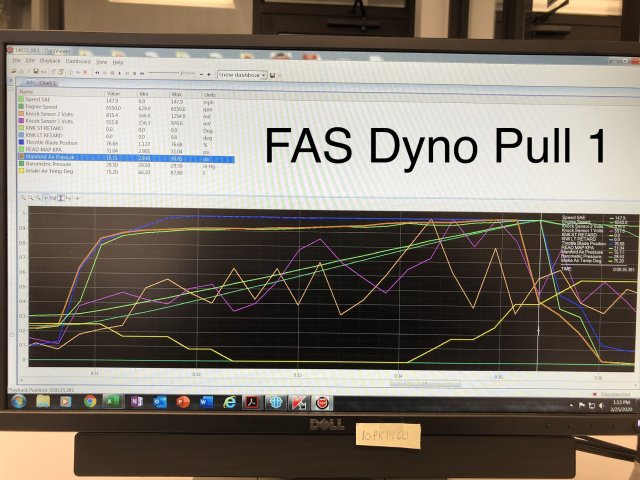

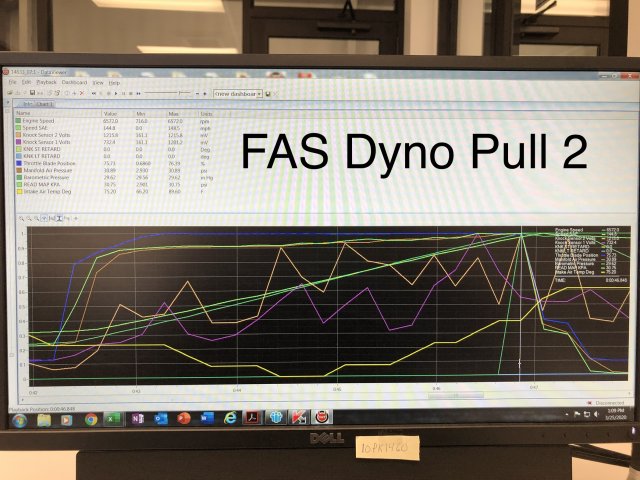

These numbers on pump 93 with a bottle of Octanium for insurance. Look at the low knock sensor volts, could probably give it mire timing even and get close to 875 but I’m happy with it, for the moment at least lol

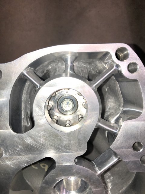

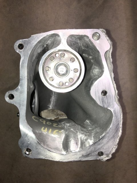

When I say hand port matched my snout I mean snout outlet to the FAS plate inlet, I didn’t touch the inlet side of the snout. 74DD083E-772A-42E6-966D-1F5F52CF9418.jpeg DF9EAC3D-E383-4E4F-8131-7A62520C3558.jpeg E62767DF-064C-43A4-99B9-35D17741A2F9.jpeg

I have “another” blower I have apart, I’m going to be hogging out it’s stock inlet plate and will be putting it back on in maybe 6 weeks or so, so up next in my crazy world of testing stuff is that combo with this same snout and the FM TB. We shall see if a $1000 plate beats 2 hours with a die grinder And a few burrs and sanding rolls or not :)

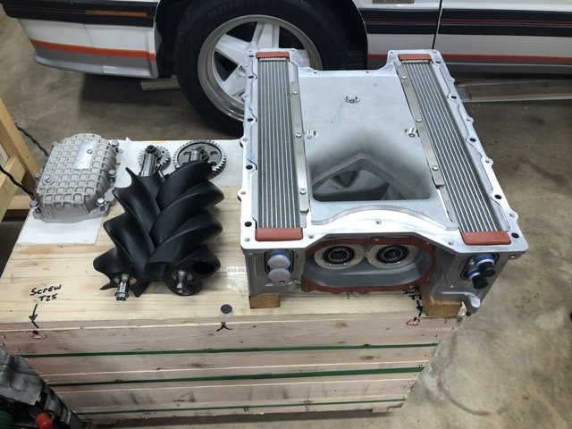

Now it’s time to fix my first blower :( Blower 101 any one?? :)
20,163
What is that parked behind the crate?
