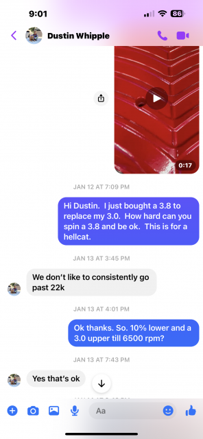

Right. I lost track that you were temporarily going with the stock block. I remember you saying that now. I’m talking to too many people about stuff. The 4.0 is a good choice then. Adam had a conversation with Whipple about my reliability concerns due to all the chatter and I was told that the 3.8 can have a problem with rotor deflection due to the larger size. It is not designed to be a high rpm blower. 18k for reliability and max of 21k for racing (“pushing it”). We were using the 3.5 (within those limits) at Houston last year and the performance was astounding with no damage to the blower. Just something to keep in mind for later.
That is definitely good to know, I think with how efficient it is I probably would never need to lean on it super hard anyways. You've already proven just how powerful it can be even with a relatively tame pulley combo.

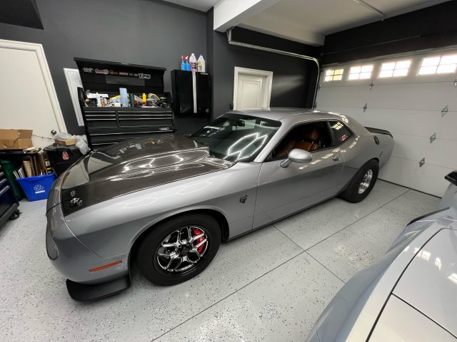

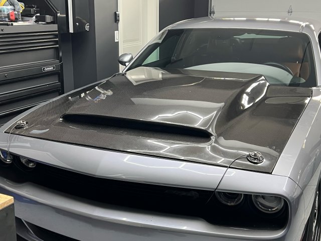

Anderson Composites Demon Cowl hood showed up this morning, 1 day after a car show that I had to show the car in for my work lol. Was an 8 hour reminder that I generally really hate car shows.
Anyways the hood fits and looks great, I'm definitely impressed with the quality. That said the landed cost in Canada for this hood is through the roof but I'm happy with it regardless. Drilling for the hood pins was incredibly nerve-wracking, but it all worked out just fine.

They are beautiful. Did you by any chance weigh it before install. I would be curious to know how it compares to stock.

They are beautiful. Did you by any chance weight it before install. I would be curious to know how it compares to stock.
I know my redeye Anderson composite hood weighs 5lbs more than my stock 2016 hellcat hood.
I didn’t unfortunately but just from feel I’d say @RGPIII Is right on the money.
That’s what I was thinking. I believe the dry CF is considerably lighter. I know the dry CF deck lid and roof panel are significantly lighter than stock and something I would like to go with but for the high cost.

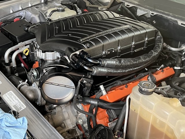

So this is interesting. The whole time I thought I was making 23 PSI on the 4-inch pulley with a 10% overdrive lower. Mike and I moved on to get ready for the race gas tune and he recommended that I put the smaller pulley on, which I was unsure of. He said that based on aircharge it looks like the car is making 17 PSI peak, and asked what I was seeing on the dash. This morning I made a pull and watched the dash and saw 16 PSI meanwhile, my HPTuners log is showing 23. It seems as though something is wrong with my HPTuners logging setup for boost pressure.
Makes me not feel as bad about those 10.30 passes last Friday but I'm surprised it's "only" making 16-17 PSI based on what I have seen other guys making with the Whipple 3.8. Maybe the one's with the hellcat boost bypass valve are geared differently or something like that.

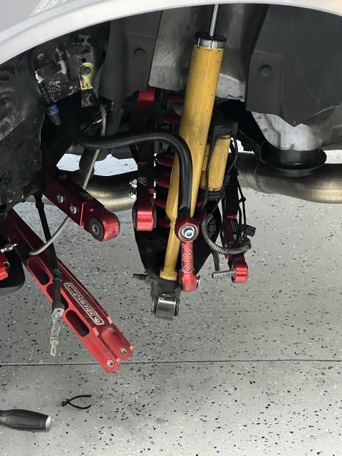

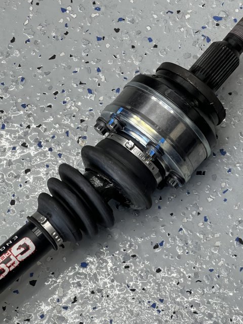

Finally got around to swapping the drivers side axle shaft with the torn boot out. Should have this back together soon and then going to try the race gas tune out at the track tonight for the first time.

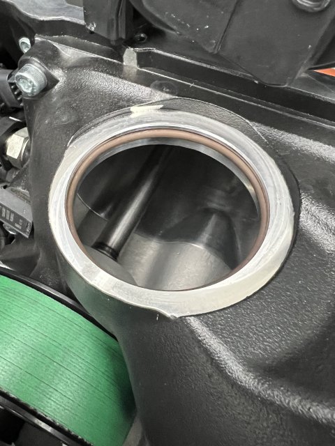

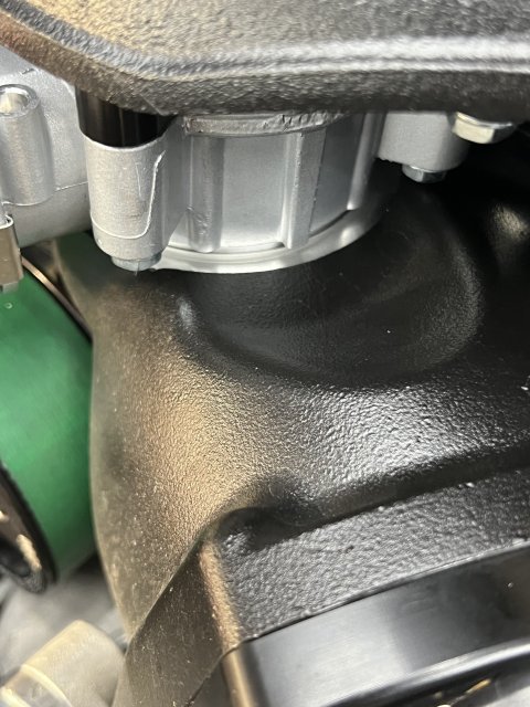

I took the blower lid off the Whipple today and noticed that the O-ring for the bypass valve was just sitting on top of the snout against the bypass valve, instead of being in the groove where it is supposed to be.
I got that sorted out and the car seems to run better and pull harder. I imagine it would have created a vacuum leak but based on where it is I’m not sure how much it would affect things.
I won’t know until I get to the track again if that makes it any quicker. The big issue I’m having is the car won’t 60 foot. It’s in the mid 1.5s and doesn’t feel like any power comes on until third.

My 60’ should be a lot better next time out. Have a few things to try and installing an ice tank to take care of IATs. If the bypass wasn’t sealing you definitely had a boost leak
Mentally this is one I'm struggling with, the car feels and runs a lot better under normal driving now. But under WOT when the bypass valve closes would it have a boost leak from there? I can see that it could still leak from the snout, but I'm not so sure about having a boost leak from the blowoff coming from the blower lid at that point with the bypass closed.
Maybe I'm looking at it wrong and over complicating it in my head.
I’d think you’d be sucking in unmetered air. Did you get logs? Your tuner should be able to spot it
