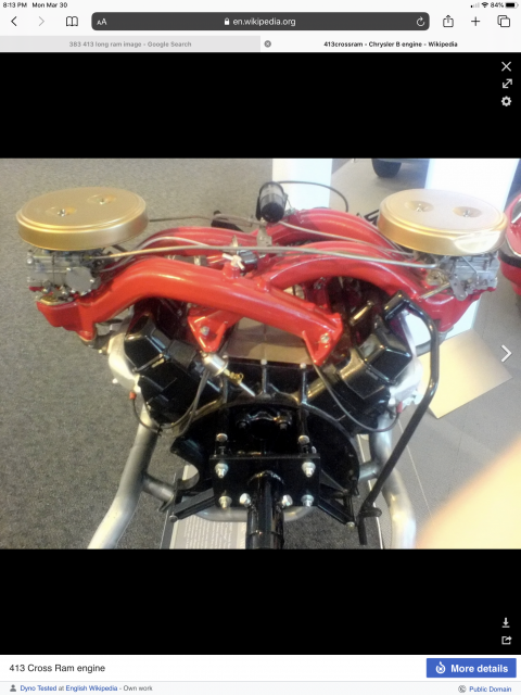

There is I believe one caveat that allows a low deck factory intake to go on a RB block, that would be the the 383, 413 cross ram, AKA long Ram manifolds because they were a 2 piece manifold with opposing runners feeding opposite cylinder banks see attached
imagine those long runners with our power chillers and a couple of laughing gas NO2 plates under each AFB carb
