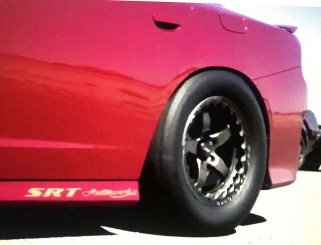

Anyone have 315 on their Chargers?
Do you require a spacer? If yes; do you drag race with spacers?
I have 305's but once that's used up I'll get 315s. Our chargers should be able to accommodate a 315 tire without modifications like the Challengers.
I don't believe it's safe to be running spacers on the drag strip but others can chime in if they've done it.
3,612
11,638
Here’s a picture. Not my car. No spacers being used. 7C575B2C-9517-42DE-88C2-623C4C8D55BF.jpeg

Here’s a picture. Not my car. No spacers being used. View attachment 9953
Appreciate it, and I understand...the Challengers have more room than Chargers.
Anyone have a Charger that already has 315s on and drag race?

To complicate this subject more...was thinking about going with a 315/50r17. What are your thoughts and appreciate your feedback?
1,402
2,044
You got that backwards.
Widebody aside...charger has more room than challenger.
