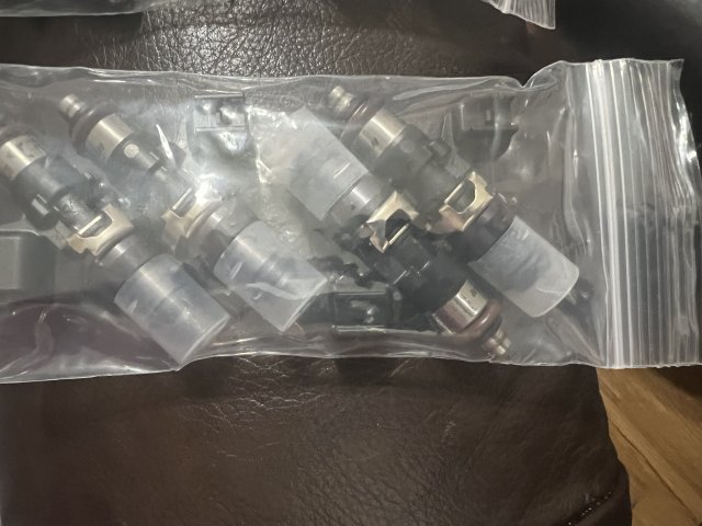

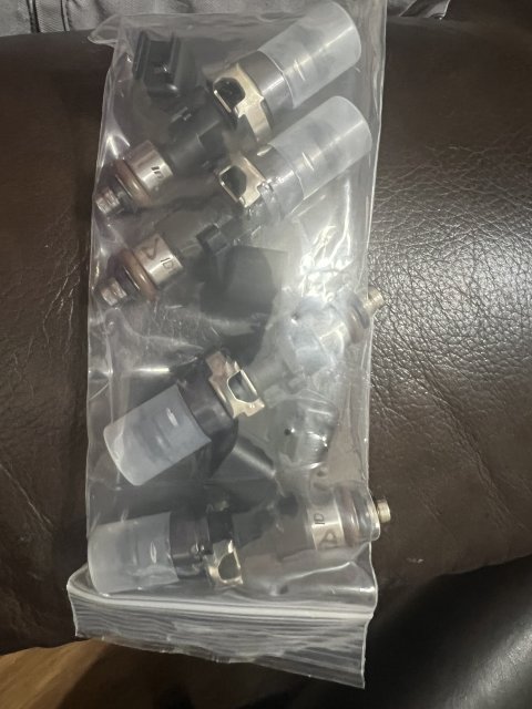

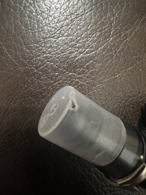

Should I worry that the plastic protectors were pierced?
AlleyCat
AlleyCat
#1332
970
853
Oro Valley
16 HC Challenger
Thread Starter #78
Weird. They crossed out 24 and marked 48
5,932
39,539
#79
@AlleyCat
@fumanchu182 may be able to help you out. He has a fuel injector cleaning system.
If he doesn't chime in, send him a PM

I hope they do not need cleaning. They are supposedly brand new.
