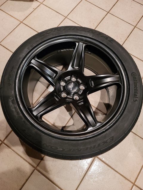

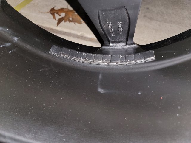

Idk I got different tires and now there's even more wheel weights. Wonder if the rim has more weight on one side than another... think I'm going to take it to a different spot and ask them to see if they can do better.
To me this isn't acceptable but idk 😐 😕 🤷

Pic of the 'dot' on the tire in relation to the stem & those weights ?
There are no dots on the tire, if you are referring to the red and yellow dots I see on tires for mounting and balancing.
And the wheel weights are 180 degrees from the valve stem...
That is 1/2 the weight of another wheel. Turn it inside out.

Tell them to line up the triangle with the valve stem and rebalance it...should be much improved.
That sucks, makes sense tho that they would be 180 from the valve stem as it's the heaviest part of the wheel.
Does that have meaning beyond pointing to the wear bar/indicator ??

I have found there is a heavy and light side to most tires. Looking at pic, all the weight is to offset heavier side,(Valve stem area,) hence the reasoning to move the tire the 180* and rebalance...the very worst is the same weights would be on other side...but I suspect a noticeable reduction will occur as the stem/tps should about weigh the 4 oz of weight currently on it.
