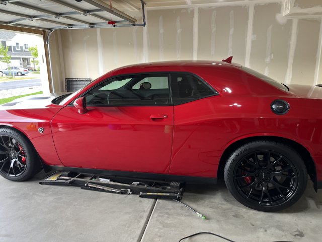

Drinking a beer in my backyard after a long day of cleaning the car. Drive about 4 hours West on I-10 and then 6 hours North on I-15 and I’ll buy the first round!
