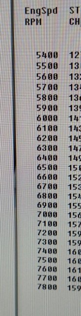

Thank you all for the feedback. I just ordered a Pedal Comm. last night and I know with that I'll need more RPM or an A8 because the Rev. limiter comes up to fast in !st now.Before I can grab 2nd. Ma gave me $hit about spending the cash "like the cars not fast enough already" I want to put in her R/T be for I put it in the Cat.

Not for real, at least in mine, I get an ignition cut at 6200.
Ya but your in thin air.
