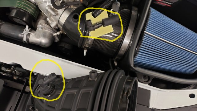

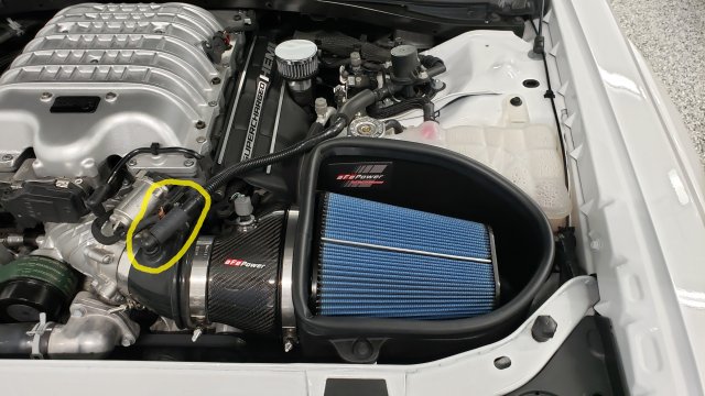

Here is what I did with AFE CAI manufactured for the Demon adapted to my Redeye
Picture 1 is the result

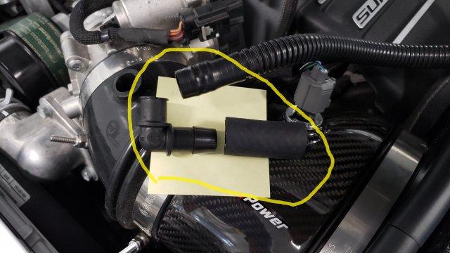

Picture 2 is what parts we ( Redeye and 2019 Hellcat) have to add and/or modify to our PCV valve system because it not the same as the Demon. The elbow from our OEM intake boot can not be taked out and anyway couldn't fit in the AFE intake boot. So I bought an 5/8 plastic universal elbow from auto parts store and cut 1 end to be flush with the inside diameter of the AFE intake coupler (throttle body/CF AFE boot). I also bought 5/8 heater hose (1 foot). To take off the OEM plastic hose from the OEM intake boot elbow, I gently heat the end of OEM plastic hose with a heat gun protecting any other around parts, with some leather working gloves from over heat and pulled out. Result: the new shortened at 1 end universal 5/8 elbow fit perfectly in in the AFE coupler hole and and the 5/8 heater hose also fit perfectly and very tight over our OEM plastic hose end. 20191027_104537.jpg

Demon and MY18 Hellcats have the same PCV fitting as a MY17. The 19 is different, which you’ve unfortunately found out the hard way.
Picture 2 is what parts we ( Redeye and 2019 Hellcat) have to add and/or modify to our PCV valve system because it not the same as the Demon. The elbow from our OEM intake boot can not be taked out and anyway couldn't fit in the AFE intake boot. So I bought an 5/8 plastic universal elbow from auto parts store and cut 1 end to be flush with the inside diameter of the AFE intake coupler (throttle body/CF AFE boot). I also bought 5/8 heater hose (1 foot). To take off the OEM plastic hose from the OEM intake boot elbow, I gently heat the end of OEM plastic hose with a heat gun protecting any other around parts, with some leather working gloves from over heat and pulled out. Result: the new shortened at 1 end universal 5/8 elbow fit perfectly in in the AFE coupler hole and and the 5/8 heater hose also fit perfectly and very tight over our OEM plastic hose end. View attachment 10169
Did you have any "fit up" issues with the headlight intake tube and filter housing?
Frenchcat
#1143
87
396
t-r
No fitting issue, it was like father in mother( not sure if I can write this in english lol)
