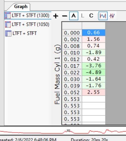

Since you are doing it your self I'd plan on getting those numbers a lot lower than 5 percent. This is just a log I have. I have dialed my injectors in even a little farther than this. This looks to be a pretty short drive here like really short. But you get the point
Take a look at this ST graph this is how I gauge how close I really am.
What are your graph settings on the histogram? Is it "last" and "view zoom data only" or is it "average"? Mine doesn't seem to work for "last" setting.
Its a bug in HP Tuners. Last will only work if the log was just recorded and not closed.

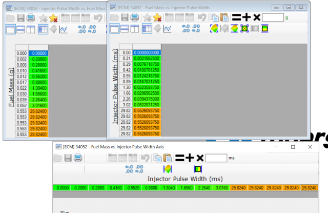

Well, you guys motivated me to dial the injectors in tighter. Thanks for the tip on the histogram setup, made it super easy.
I don't think I can get much closer than this. This is from a 15 minute drive and the values are an average for the entire log so dang close.

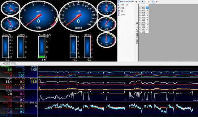

Yeah I was definitely doing it the hard way. It worked but was super time consuming. I'd watch the trims at various inj pw then go in and adjust the pw by trim % give or take a little. The fuel mass way worked 100% better. Somehow I had the trims 5-7% with the DUMB way, but now they're super dialed. I'm gonna do the same on my E85 tune to tighten those up.

When I was doing this...I setup the STFT+LTFT vs both IPW and Fuel Mass (2 seperate histograms) so I could see the difference between the 2. It is sometimes quite substantial to say the least.
I usually ended up adjusting fuel mass instead of IPW but could never achieve any sort of progress in the low pw areas of off-idle cruise and whatnot. I would have it bang on one pass and 10 off on another.

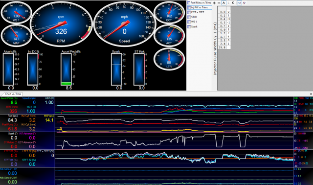

Ok yep I went back and added a histogram to log inj pw vs ST+LT fuel trims and it lines out, so it's two different ways of accomplishing the same thing. I had just been looking at logs in the charts area for fuel trims and adjusting the fuel mass at specific inj pw points in the tune. Same same the histogram just makes it way easier to know how much to adjust although I always did 50% as I dialed them in. Took a couple extra logs but better than over shooting.
7,011
18,115
Here's what the INJ PW histogram looks like for those that are interested. This sorta makes more sense to me as you're manipulating how much fuel mass is injected at a specific pulse width on the injector.
