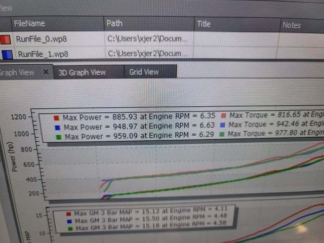

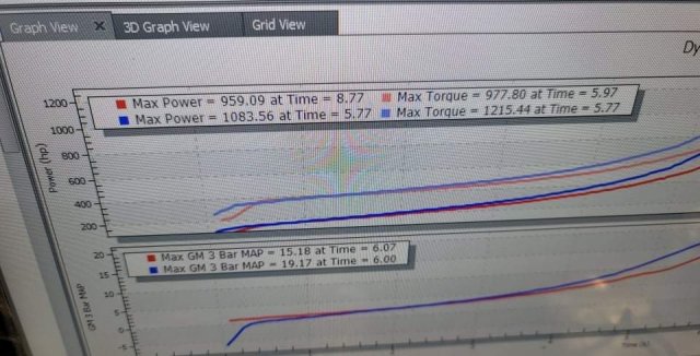

Some initial tuning from today. Pretty happy with the results so far. We had the charge pipe blow out on the higher HP pull, so it didn’t get to “peak”. Tuesday they will check for exhaust leaks that they may have heard on a pull and tweak anything needed. The “base boost” setting I was shooting for is all set. We’ll see what it does on a full pull with 19-20psi. They maybe try 1-2lbs after that to see.
So far very efficient 2B0F38BC-54F2-4098-8FEC-AAADDF9FCDC3.jpeg 5BAB8BFF-1C41-4A2A-8CFD-964513B93B51.jpeg
So far very efficient View attachment 52756 View attachment 52757

Looks very good. But with the higher pressure and boost, it may blow off sumtin on the exhaust side. Keep going.
Most gas setups don’t pay a ton of attention to drive pressure until you get quite a bit higher in the boost, but it’s always an area that I’m interested in. Not enough credit is given to the drive-to-boost pressure, it’s critical to me.

They are going to check for any boost leaks in the exhaust Tuesday hopefully. We will make a couple more pulls to verify all is well. Want a clean pass on the 20psi setting. Then one or two more at 22-23psi probably to see if we can use that for an e90 only scenario. He has some drive tuning to do with it still before I get it back.

Turbos on these cars are usually 30hp per psi I think? So just subtract 120 from 959 and its be close.
1,402
2,044
Gotta be close as you don't have the drive loss of the blower anymore...
I know Satera was claiming upwards of 100-150hp from just gutting the blower on a compound setup and using it for the IC core only...sounds about right.

Yea, looks to be 30 per, we shall see. Hopefully it sees the dyno tomorrow again and we can button it all up aside from some daily driver street tuning. I want to see the clean pass at 19-20psi.
Damn Boyyyy, 1100 / 1200, heavy hitter !
