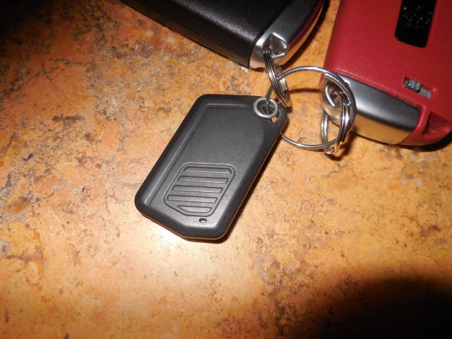

So with all the great advice fun jabs and car talk it WAS the battery
I am throwing out my old school methods and thinking
Despite the ignition working strong power to items such as radio lights etc, a try at a jump start along the way load test at autotive shop showed bad battery
We are now driving our hellcat once again!!!

The "new" multi-door ('23 Charger, aka Crew Cat) didn't start today. I wasn't surprised and had already asked the dealer to put a new battery in it before shipping it. Well, that didn't happen.
It'd been on a solar charger for about 12 hours before today's starting attempt, but that apparently wasn't anywhere near enough, surprise, surprise.
Okay, so I put a good battery in it - happens to be the same 94R as in a 1500 - and...still no cranking. Hmm. Wonder if it's a bad fob. Tried the other red fob, no difference. Tried the black one, resulting in success.
But, the red fobs will lock and unlock it.
My girlfriend's been communicating with the dealer, initially about the abused battery, then about only one fob working (this is in real time as I'm writing this).
Turns out there's a chip on the key ring that must accompany the key in use, which happened to be the black one. That's good news. Now it remains to see if the nearest dealer will accept her showing up with the original bad battery and get a new one...without bringing the car.
I'd never heard of anything like this chip, but if someone else runs into this issue, here's the solution. You can't leave home without it. DSCN5903[1].JPG

Wtf? A chip? Is that their new security? Lol. You now need 2 fobs to start the car, like 2 keys to launch a nuke. Seems like overkill to start a car

Resuscitation alert.
I'd never heard of anything like this chip, but if someone else runs into this issue, here's the solution. You can't leave home without it. View attachment 154877
Looks like my IGLA ALARM key fob.
