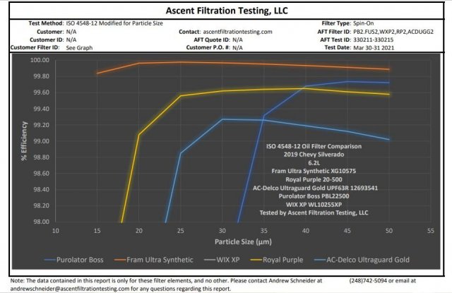

What's interesting about the "XP" versions of the WIX filters is they "open" them up, presumably to allow for greater flow as they get older???
When I saw that, I stopped using the "XP" versions of WIX filters and went back to the normal versions.

LOL, I don't, but I had allowed myself to believe that the XP version was a better filter, if you take the specs at face value, it's not "better", it's "freer flowing"...

Without an efficiency rating, the micron spec is pretty meaningless. 99.9% @ 20 is the best I've seen. This would be something like 50% @ 5-10 microns. (Don't know where the Wix went on the graph.)
The scaling on this graph is a bit misleading...
The vertical axis being only 2%...

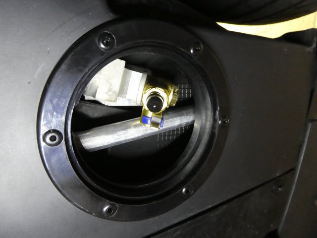

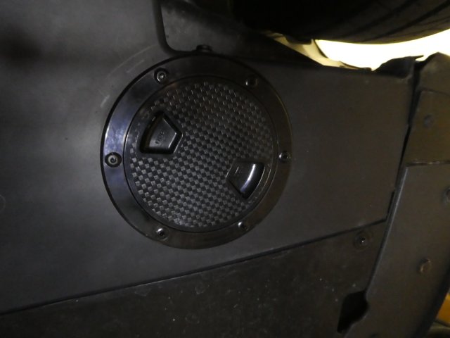

I only got 5 OCs with mine. The dealer would give me the oil and filters. I’d do the changes and the dealer would write it like they had done it.
If you got the access panel that a member was selling a while back it’s a piece of cake. If you are original, it’s still not hard. You’ll just have like 19 fasteners instead of 8.

did this on mine for oil cooler drain access - saves a lot fastener R&R as noted above.

There isn't enough oil to make it worth wild to take off the panel to the oil cooler. Maybe if it is warm doing the change there is some in there but cold, very little
I always drain with the oil fairly hot. I usually get several ounces (6-8?). Four 10mm bolts with a nut driver isn’t much trouble, imo.
But I agree, probably not necessary in the long run.
Same here (fairly hot). Will look at it and make my determination. My OCIs are every 3,000 - 4,000 miles so (6-8) ounces on a 7 quart sump probably doesn't make a difference? Probably do it so I can learn and use an RV mod piece to gain easy access going forward. I should have ordered one of those access doors when I had the chance.

Hmmm, well I have two Fumotos on my '16 and they fit just fine - one is shown in Post #30. Need to know the right models to use ;-)
Yeah! That looks good.
I considered that model, but went with Stahbus, instead. Ran Fumoto on my 6.1 and the wife's 5.7 Magnum, for years. Figured I'd change things up.
