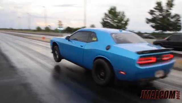

i don't have no 8 second car but I do have a 2,65 with 10percent overdrive on e85 tune but haven't been able to launch it on that tune it just spins but have a tune in the works that will help on the launch but I,m still full weight been to lazy to remove anything lol ,I think over the next few months ill work on weight reduction

Demon oem springs, BMR rear control arm and stiffen the cradle using whiteline bushing

I’m on 17 Mickey Thompson but it looks like I may have to do the 15 inch conversion
305/45? Or 315/50? For that kinda boost for consistent 60’, you would need 315/50/17

Will the 315/50/17 work in my 2016 challenger? I do have the 305/45/17
And If so why didn’t you tell me earlier this week I could have already ordered them lol
315/50/17 won’t fit as is. They do require some inner fender messaging that is still better than 15” grinding of end link and knuckle.

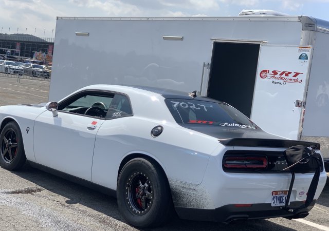

@Marc W did a nice job with his. He had pics on the other site. I'm just not smart enough to find them and show them here.

Thank you (I think). 😂. The 315-17 M/T-R has been a common combination with the 3.09 gears for over a year now. You can read all about it on the forums! On the right wheel, it only requires beating down the stiffening rib inside the wheel well where the inside edge of the tire at the front would rub. A very simple modification. I initially did it with a set of the RaceStars that are specific to the Hellcat. Combined with the 3.09’s it is the best setup for consistent 60’s without going to a 15” wheel. Here’s a old picture of that wheel/tire combo. C493D834-A883-4805-9F86-7D78FC0E8F8F.jpeg
