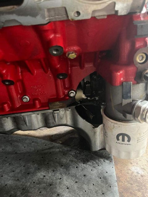

What type of damage did your engine have? I missed the pictures if you posted them. I'm guessing the damage looked similar to Jon's if your engine let go while taking a leisurely cruise.
This faluire does not look like mine. At one point this fall I was keeping track of stock failures. I saw 2 and 1 popped headgasket just over Facebook 100 percent stock cars. I haven’t been keeping such a close eye on the groups lately. But I do not think cylinder 4 was any of these. Typically it’s always 2

Mine was a cylinder #2 failure…..piston lodged in the block and the rod ripped the bottom out of the piston. Stock boost on E85, probably added around 60 to 70 HP…… a total of about 60 passes in the 3 years I’ve owned the car. i’m convinced with the majority of the failures being cylinder.#2 but there is some type of defect. I don’t have internal pics.
