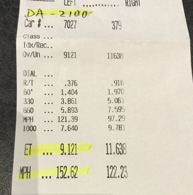

Wild Horse Pass Arizona. March 14, 2020. DA... 2100 ft E8F4A6B1-A3F0-47A2-B4B2-D6A78492D04E.jpeg CEF2FF00-019E-403D-A21F-9C3258A812DB.jpeg

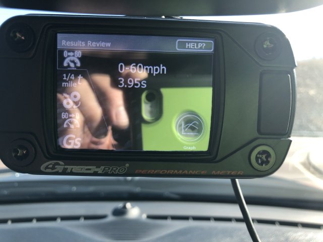

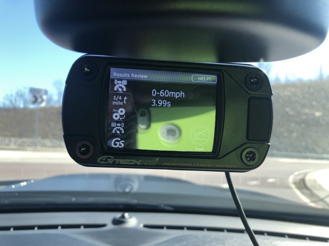

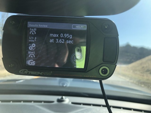

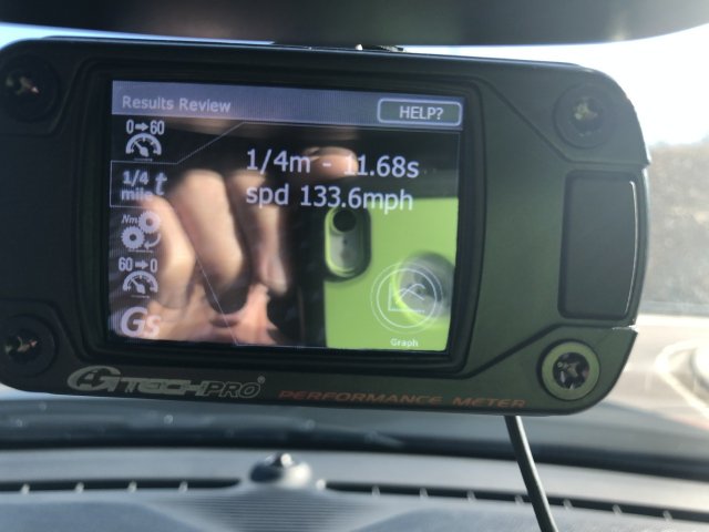

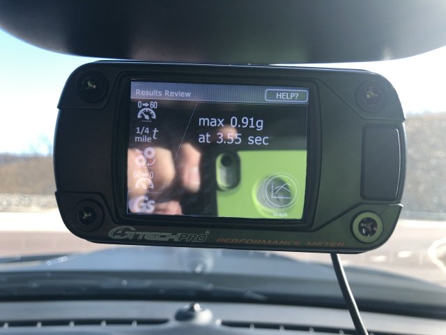

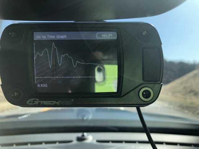

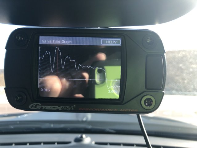

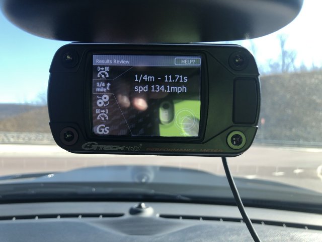

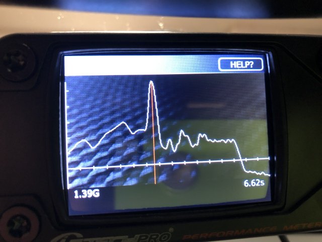

OK, here’s a question for you guys.
Installed the BMR lower trailing arms today and put down 2 test runs. 49F here so pretty close to previous conditions where I’m wheel hopping on the street on launch in both first and second on 315/35-20 Nitto NT05R at 26 psi. The bars seemed to have helped greatly, minimal wheel hop in first, maybe 1/2 throttle, none in second probably 3/4 to full throttle at the top then hit third and go floored and go. Netted a 11.7 at 134 then a 11.6 at 133.5, 3.99 0-60’s, not bad on the street. BUT the big question here is look at the first picture of what third did on a cold night about 3 weeks ago, a neck snapping 1.39 G’s. Man if I could add that to the first and seconds pulls of today I’d probably net a low 11 or maybe even a high 10, that’d be SWEET on the street. What’s up with third? I’m running stock clutch yet, think it slipping in third?? CDV is out.

Did you try that throttle body
3,812
9,028
No, not yet, that’ll go on with the FAS billet blower plate, maybe this week.
I have a RXT1200HD with Alum Flywheel and Bad Boys Steel SFI Bell on the shelf but was hoping to get this summer out of this stock clutch and put it in next winter. Think clutch slipping in third???
Can you datalog engine speed, input and output speeds? That's how you can tell if the clutch is going away.
3,812
9,028
Don’t think so but I’ll check. Local motor shop guys looked at the graphs and they said they don’t think so and these guys race every weekend, build 10-15 real race engines a week and build and dyno cars daily. But what I remember hearing hitting third on the track last weekend third was either spinning or slipping, on 315/50-17’s I’d really doubt spinning but track prep not the greatest at Island and is there ever any sticky sauce half way down the track?? Could have been spinning??
