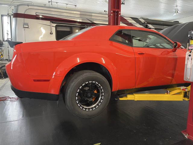

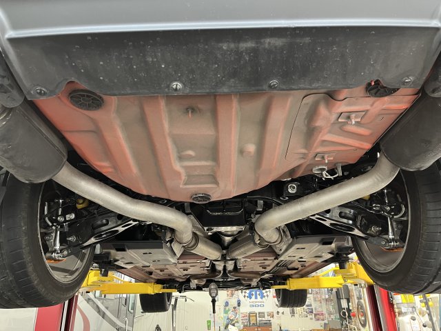

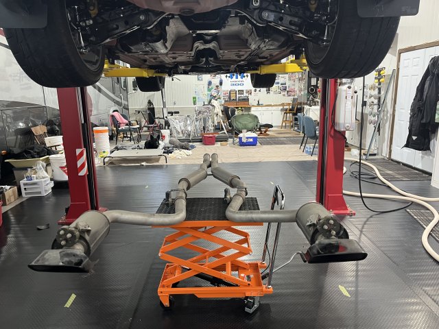

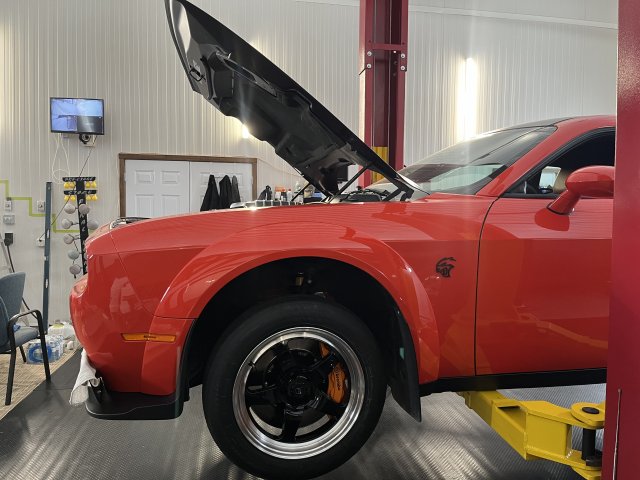

IMG_7697.jpeg IMG_7698.jpeg I have been taking my time and enjoying the “build”process as well as getting to know the car a little more intimately and am almost finished. I re-installed the exhaust and finished up everything at the rear of the car so the last thing I have to do, for now, is change the front springs out to the demon killer springs then I will take it in for an alignment. I noticed there isn’t a lot of adjustment in the front end for alignment so hopefully everything can be dialed in without too much issue. I see there are aftermarket cam bolt adjusters available which requires you to elongate 8 holes in the subframe to allow the cam bolts to work, either with a die grinder or a special tool from SPC. It would be nice if I didn’t have to go through that process. Does anyone here have any experience with their car in this regard ?
My hydraulic cart came in very handy again for re-installing the exhaust.

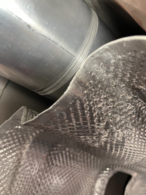

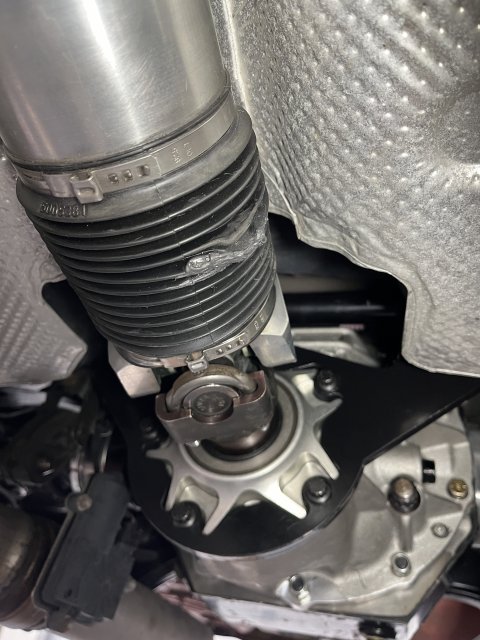

This whole setup was used when I got it and I noticed a small groove in the driveshaft when I got it all home. This was an area of contention with a few people early on in this post when I was being criticized for not following the “advice” I received about purchasing this setup. The groove is quite minor and the photos actually make it look worse than it is, but once I installed the driveshaft it became pretty obvious it was caused by rubbing on a heat shield. There was also a very small hole in the driveshaft boot which I repaired with a bit of “right stuff”. IMG_7677.jpeg IMG_7706.jpeg

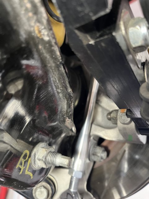

Thread Starter #85

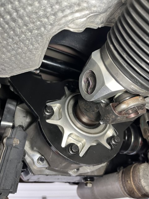

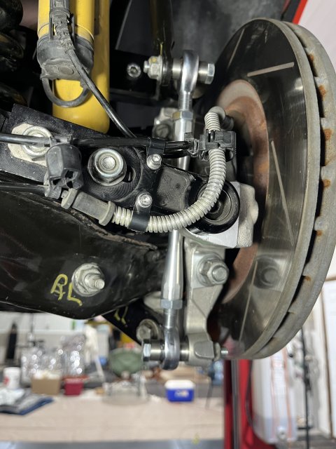

The new toelinks I purchased from HHP have lots of clearance now. IMG_7659.jpeg IMG_7661.jpeg IMG_7660.jpeg

Buy the AAD front control arms.

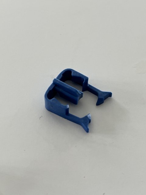

Well the fuel clip showed up from Amazon and it appears to be the correct one. $30.00 for a little bit of plastic but cheaper than the $150 Dodge wanted for the full line. IMG_7713.jpeg IMG_7716.jpeg

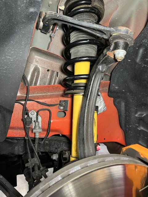

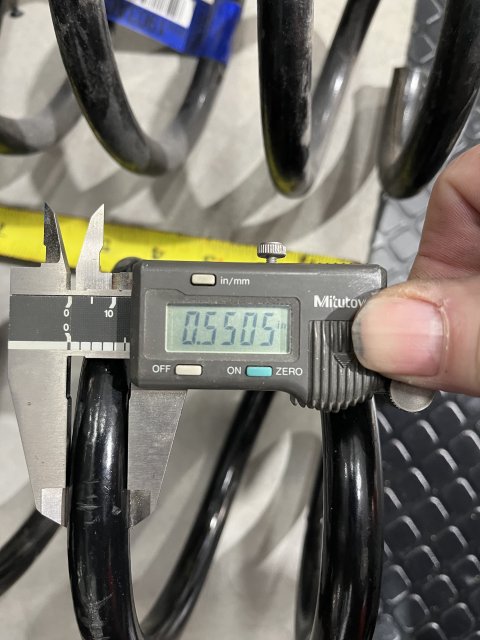

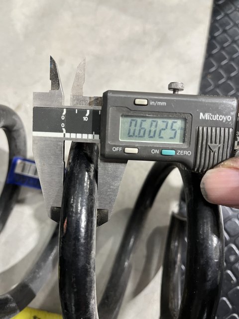

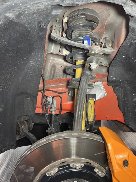

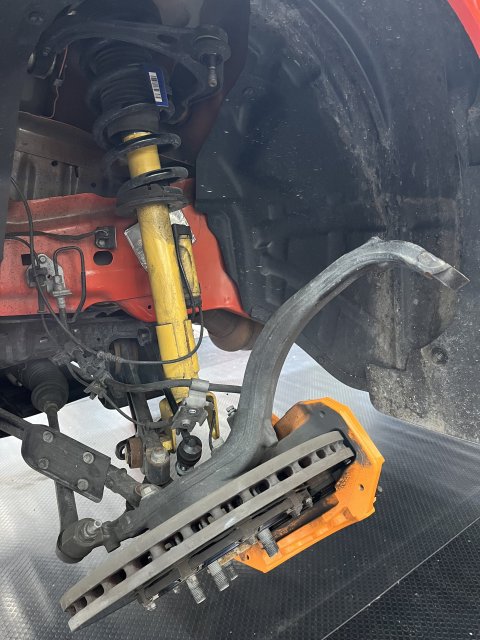

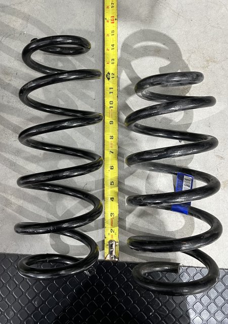

Changed out the front springs the other day to the “Demon Killer” springs I got with the used suspension package IMG_7730.jpeg IMG_7731.jpeg IMG_7733.jpeg i. They are actually from Dusterhoff Racing so maybe demon killer springs are different?
They are definitely taller than the stock Redeye springs and also a smaller diameter.

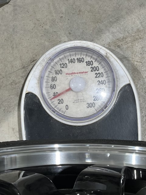

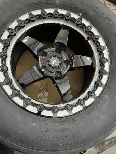

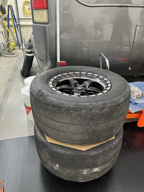

I also checked the weight of my front skinny compared to the stock wheel and rubber.

Thread Starter #92
8,762
7,687
#93
The ET street fronts are super light. I have a set almost brand new sitting here for sale (2022 date code). I switched to the sportsmans. I think my car is too heavy for the ET street fronts

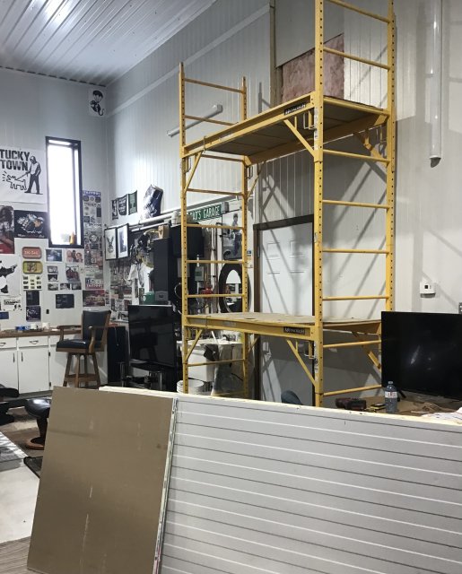

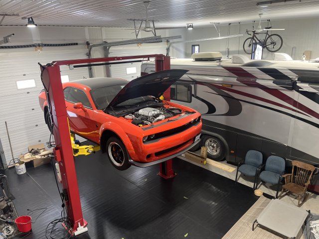

Well the car is “done”, other than an alignment, so it is just a matter of waiting for the good weather to hopefully show up in a couple of months.

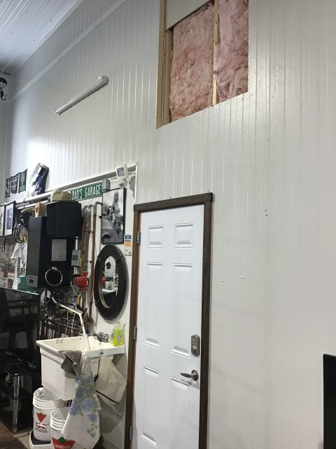

In the meantime I decided to go ahead with a mezzanine project I have wanted to do since we moved here about 2 1/2 years ago. We live in a barndominium style home that was built in 2020 and although it was framed in during construction, there wasn’t an entrance to the shop from the second floor, which is our main living area, so I decided to go ahead and finish it.
So although this isn’t a post about the car it is the car’s place.
IMG_8393.jpeg IMG_8392.jpeg IMG_7823.jpeg IMG_7825.jpeg IMG_7828.jpeg IMG_7815.jpeg IMG_7813.jpeg

2019 Redeye Widebody Challenger
Thread Starter #100

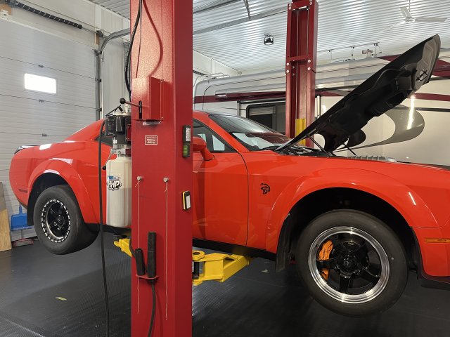

So the weather is finally turning here and we are in the April showers season. The weather still sucks but at least the salt is getting washed off the roads.
I will be taking the car in for an alignment in the next couple of weeks and wondered what the alignment specs I should be shooting for are ?
I know I read some posts on here weeks ago with that information but I can’t seem to find them with a “search”.
The car will still be street driven as well as the drag strip and I do have the AAD drag pack kit installed, so once I get an alignment and some readings it should be pretty easy to change.
So I am wondering if I should get it aligned to stock specifications and then I could call AAD and get their recommendations for the drag set up ?
Hopefully someone could either point me to the post or reply with some specs.
The guy I bought all the parts from has rented the track for May 9th and invited me to join them so the testing will be starting soon !
Thanks.
