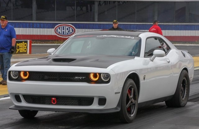

Some years ago, before much was available for these things, I started out with the typical E85 pulley build and tune with otherwise stock motor. 2016 Hellcat. Build was a +10 crank with a 2.65 Griptec, ID-1300 injectors, off-road mid, DSS 4” driveshaft, 3.09 rear, RaceStar frontrunners and 17x9.5 rears with M/T ET-R’s. We saw 916whp at about 1500’ with this combination using a trunk mounted icebox to control IAT. That was very good back then. That combination at 1500+ da ran 144 mph in the 9.6 second range. Car was 4500 lbs. 643937D1-739E-44BA-B65D-BA45396132E4.jpeg

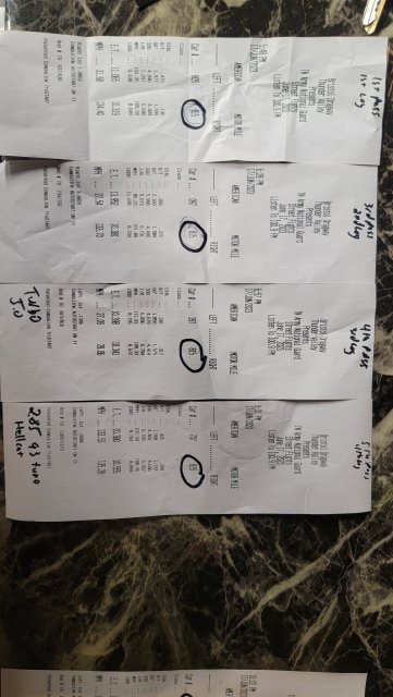

alright so its been a minute. figured id take a break of just get to work on it. last night was track day. since last track day Jon and I fixed the BPV that was leaking. swapped out injectors to bigger ones and got them dialed in. unfortunately my 10% lower didnt come in until the day of racing so i opted to wait on the install.
Attached on some of my track slips.
Something is wrong with this thing and I cant figure it out. Im actually a touch slower than previously. (previous was 10.2 current 10.3).
my 60fts were 1.5
i ran into Epling and his son and they talked with me, and suggested i leave in 2nd gear with a 3.09 rear and let her eat. as you can see by the last slip, it just blew the tires off. I was up against a 93 pump gas 2.85 upper hellcat and couldn't run him down. I'm dynoing 832whp. Something just seems off.
Epling also suggested a different torque convertor/stall. What are your thoughts on this? I'm sure it could help me off the line but that doesnt change overall power being made. I didnt trap any higher than 135mph.
additionally I swapped out my 2.55 upper for a 2.72 upper just to see if im possibly making too much heat. The logs show with both pulleys IAT stayed under 100 degrees. So I dont think thats the issue. Help me out guys and gals.
my 60fts were 1.5
I see part of your problem. Thunder Valley. From what I understand the prep is really bad these days?

might want to see when the throttle fully opens in the log. How much timing is being pulled on the launch etc. how’s the track condition? Can it take the full power on the launch or etc

Need to look at your throttle body closing. I know after you replaced the bov it sucked the throttle body closed. I only looked at your log for about 5 minutes but it looked like it was starting to close a little. As far the prep. I can give you another soft launch updated got the new injectors but if you are wanting the mid 9s in 3500 da it is going to take a good 60 ft.
Which brings me to my next question. I cant do much about DA and it was 3500 here yesterday. I could always use more seat time and get better off the line. thats a given. Would a different torque convertor/stall speed help with this? I only ask because that was a big thing Epling and son was suggesting to me yesterday. If it is a good option that which one/speed?
