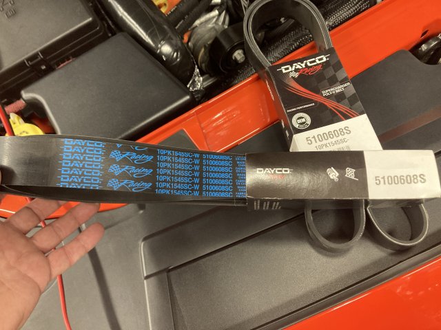

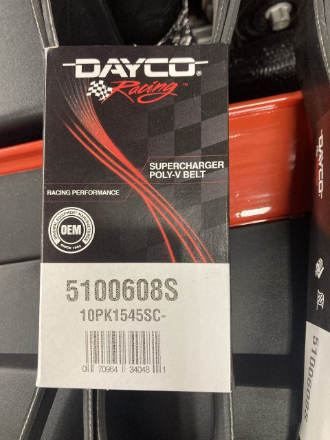

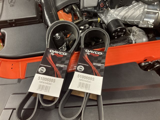

I use these belts, they are made for supercharger use, they hold up well and I turn my superchargers pretty hard, used same one on my whipples as well when I was running them.
View attachment 162327 View attachment 162328 View attachment 162329

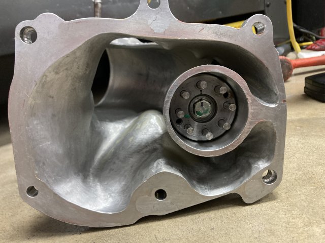

I tried to cross reference from gates k100572hd to fine the dayco supercharger belt to match that and with no luck....even put down the dimensions of the gates and still no luck....and by the way do you still port hellcat fuel rails if so im me the cost I have set that needs to be done. thanks

Hi Robert, yes, I still do fuel rails and make magnetic drain plugs as well. I’ll send you a direct message.
