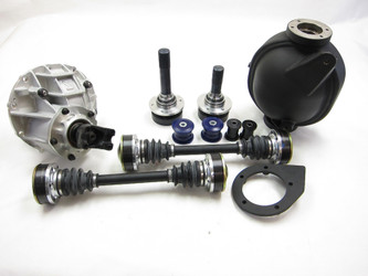

The driveshaft shop also has improved on the https://highhorseperformance.com/th...t-challenger-srt-srt-hellcat-6-2-6-4l-manual/
When purchasing this kit then you would also have to decide, if you want a carbon fiber driveshaft or an Aluminum one. John had chosen Carbon fiber for weight savings and
I spoke to Frank a while ago ( he is retired now) about the CF and he said it is actually stronger than the AL vs most people thinking it is not. He said they apply an extra coating on the outside of CF for protection.
From when John had the 1st DSS 9 inch kit installed for his Top cat ......... this new version, I know he would be installing the new kit for strength. I think John would not gone past this like he did with his Mopar Drag Pak. On his DP he had it Back halved for the wider drag wheels. It was done beautifully. It already had the solid rear axel.
I know he would have continued to build his DragPak vs Top Cat....but then again knowing him he would have been building both! :cool::cool::ROFLMAO:

Ok here is the Top of the line combo of some friends who race their 8 sec Hellcats.
https://highhorseperformance.com/billet-hellcat-differential/
And the DSS Axles and halfshaft 😎

That rear may be my next purchase. I like that I get to keep my axles and braces. Plus the added piece of mind that my diff isn’t going to explode on any given launch.

It’s an after market case with stock internals. I would put a better carrier in the stock clutch’s suck
