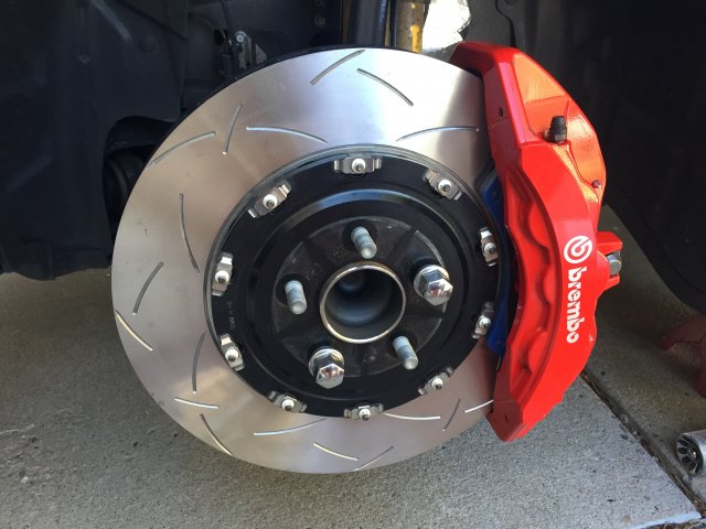

I switched to Z26 brake pads on 2 different sets of rotors and both of them developed hot spots . Is there a brake pad that is won't cause hot spots on ther rotors ?

Stock pads. I did that to French cat's rotors. He went back to stock and no problem.
We did a couple runs back to back as it was cold out and I was losing brakes on the 3rd pass. Had to use the second turn off for return road. You would get what that means.😳
I will gladly deal with the dust and keep the front of my car looking like it should.
I wash the stupid thing just about everytime I use it anyways.

Those were my original hellcat rotors . My new race brake rotors are starting to do the same and I want to stop it before it get too bad .
I guess stopping at 140+ mph on a short shut down area is not good for the Z26's
True that! Those Porterfields will work and won't break the bank. Hawk makes some products that will work for you also. OR, do just short of what I do (I change rotors and pads for racing), change back to your Brembo pads for track use. Then bed and go back to Powerstop for only street.
I don't mind buying new brake pads . It is cheaper and easier the swapping rotors/pads or ruining the rotors . I'm going to look into the ones you guys suggested and see what suits my needs the best,

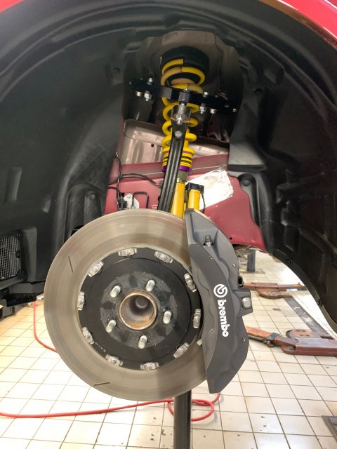

Also went with DBA rotor rings and re-used the OE hats. They’ve been great for street and track both. A little over $800 for the pair if you do it yourself. Easy not to mess up since they’re non-directional.

You use those DBA’s for HPDE use? If yes, what pads, Sir?
Yes and easily swap out my front Stop Tech for the OE Brembo pads on track days. I actually bought a hardly used front set of backup OE Brembo pads for a song. I keep the same set of Hawk pads on the rear for both street and track.
DBA has a pretty good explanation on their web site about how they are designed for cooling.
