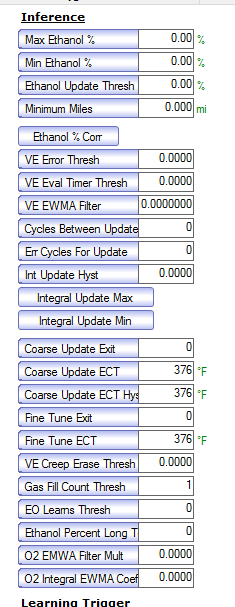

Wondering how this type of works? They use the a/f ratio to know the e85 content and make the changes?

They use inferred logic from info given by the o2 sensors. Same way GM and Dodge have their flex fuel setups. Ford uses a sensor. I may have mixed up Ford and GM but you get the idea.🤔
Arguably this method is slower to react to changes.

E85 is just a regular tune with changes made for the fuel used. Flex is completely different. Not sure which you're asking about.

To make this post even more fun these cars aren’t even tuned in AFR 😂 isn’t dodge fun😊
if a straight e85 tune is wanted. There are many changes to be made to get the afr gauge in your car to display correctly. A lot of tuners don’t do that and just adjust injector data to make the e85 work.
As said flex is a whole different game.

Yeah it would be how the flex tune works...
I was watching a video and they were talking about the neural network being disabled when using a flex tune. Just trying to understand how it works after watching a whole bunch of videos on hp tuners

There are very limited videos on hemi tuning. Everyone is pretty hush hush about it. But whatever you saw about flex fuel not using NN is false. I bet 99.9 percent of all flex cars still have NN enabled.

Keep in mind different tuners do some things differently, so there is not necessarily only one correct way of doing things. I personally am not a fan of inferred flex tunes, so we do not do them for customers. I realize tuning information is "hush hush" with the hemis, but the just of it involve installing a software patch then there are a lot of changes within the flex fuel tables that have to be modified.

I like flex option for daily driving reasons.I'd never want to push one to the limits as far as timing goes. I see a lot of tuners posting dyno numbers and saying only fuel change no tune or boost change. That can be dangerous. Also depending on the tune the learning takes time so if I have e85 in and run it low and fill it right up with 93 and go floor it right away. There is going to be a whole lot of timing coming my way way and if to aggressive the knock sensors wont stand a chance. Also hp tuners isn't 100% there yet. My car has a glitch with the flex patch where the fans will never shut off. They've been working on that for awhile now. If I sent my PCM in and had it flashed to another OS I wouldn't have the issue.

Here are a few pictures of a non flex tune so no values are entered. But maybe this will help give an idea of just a tiny part of what is required to make the flex work.
