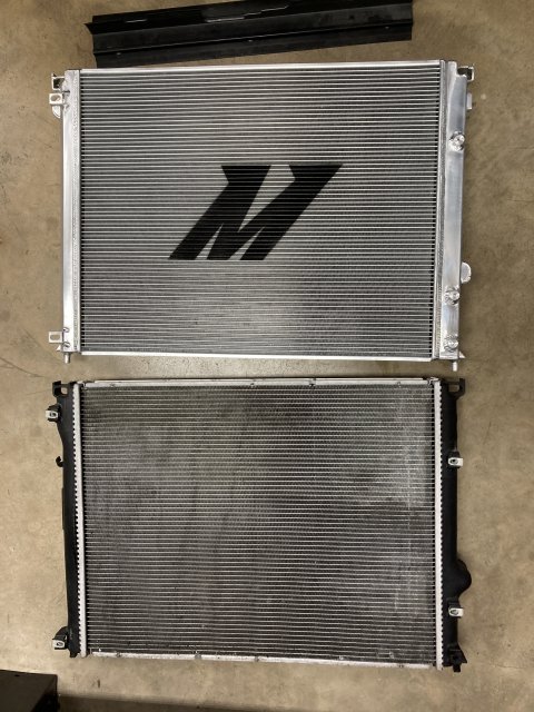

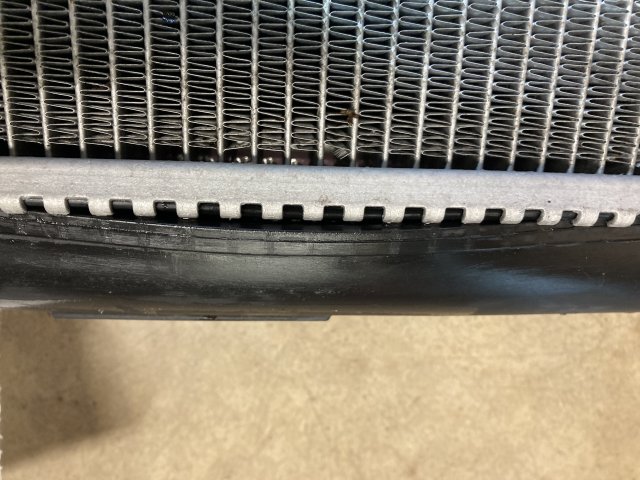

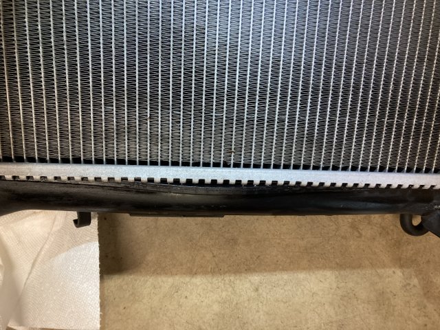

Mine did the same thing, could not find the leak, it found me top of a 1/4 run, luckily it let loose when I let off it it could have been bad. Tank separated from the radiator about 6-8” long and emptied it in about 10 seconds. Check the sides of the tank for signs it’s being pushed out from under the crimps.
3,635
8,546
This is what to look for, Replaced it with a all welded together 100% aluminum Misimoto one.

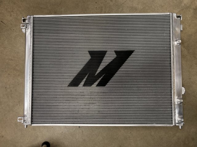

Id bet its leaking from a seam on the radiator. look up the replacement Mishimoto radiator. very nice product. eliminates the plastic end tanks.
3,635
8,546

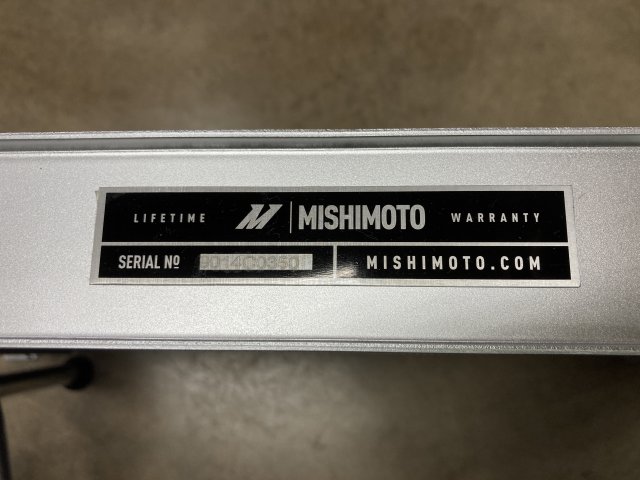

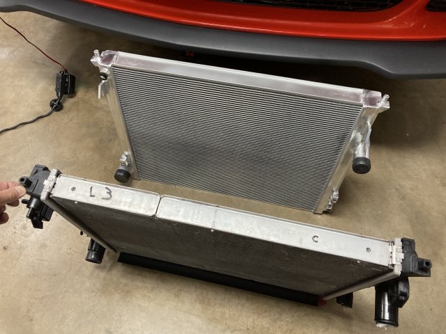

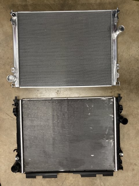

Like this, pricey but works excellent, keeps up with the cooling needs of 1100 wheel no problem, and gives peace of mind it won’t happen again. Well worth the price, direct no hassles bolt in.

Changed myself, it comes right out the bottom, not that hard. No, the whole facia does not have to come off lol. I posted pictures of how to do it somewhere.
