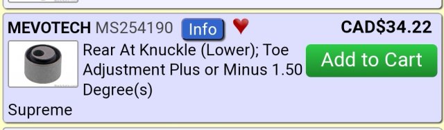

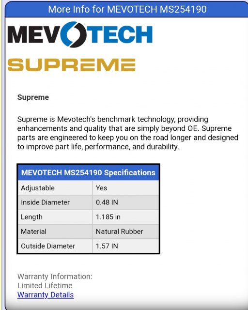

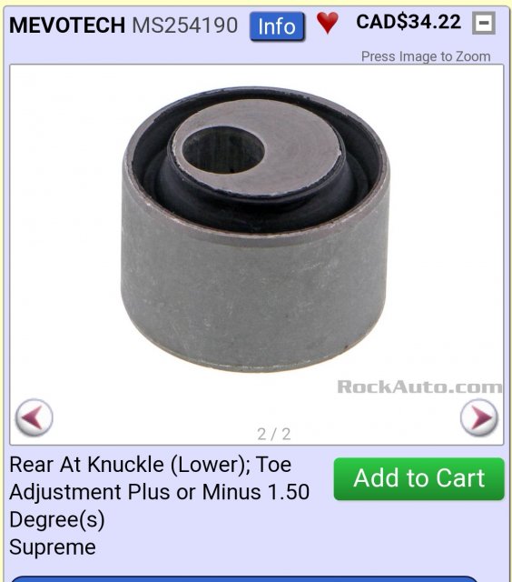

I looked on Rockauto and they don't have it listed but they have the Mevotech equivalent. The pn for the Moog is K100173
This should give you an idea. Screenshot_20230326_123903.jpg Screenshot_20230326_123828_com.android.chrome_edit_2005878305938194.jpg Screenshot_20230326_123833_com.android.chrome_edit_2005907625878294.jpg

So does this adjust camber or toe
Camber. It installs on the knuckle end of the rear upper arm. The Moog one has notches in it so you know what position you are installing it in.

I have seen those but guess you need a press to get the stock ones out and hopefully they are pressed back in where you need them
A press isn't hard to find if the trusted ball joint press doesn't cut it. As for where you need them they have a groove for different increments. I don't have the instructions yet but I'm sure you have to measure centerline from level or something. I will find out when I pick them up at work on Tuesday.
