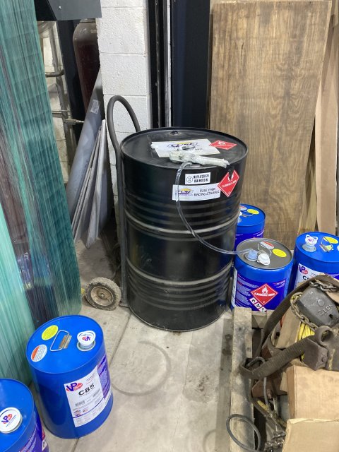

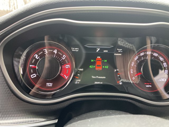

Gotcha, Me when I’m out driving my car it’s play time either hunting or practicing so I need to have all the power available 100% of the time. Like bull there isn’t a one time I’m out that car doesn’t see a buck 48. Here was the prices here over the weekend testing in the mid 70s so I keep E98 on hand to bump it up to 85. Mileage?? I think a M1A1 gets better mileage then me lol

We need to get you a drum pump :)

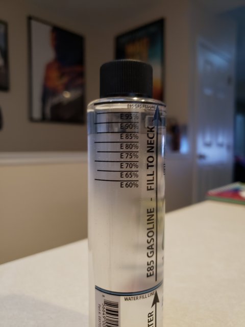

@vortecd if you have more than one station I'd check a couple. Your sample "appears" a bit cloudy, at lest more cloudy that what I see from Speedway. Thortons and Raceway here were cloudy but measured E85 which tells me their base stock is likely a hydrocarbon derivative or some sort. May not matter, but clear made me sleep better at night. I think I showed the difference on one of my E85 videos when I started off testing fuels.

Jon thought it looked clear. I have only seen mine so nothing to compare with. The station is only a few years old and has had e85 in the tank from day 1

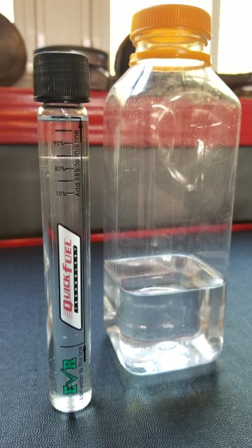

What mine looks like.
There are other local brands not near as clear.

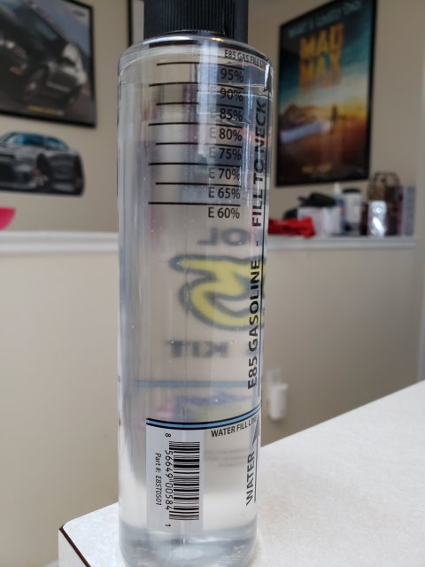

I shook it up pretty good last time and probably created the bubbles.. I tried it again with less shacking looks to be just over 80% but clearer

That looks pretty good right there.
