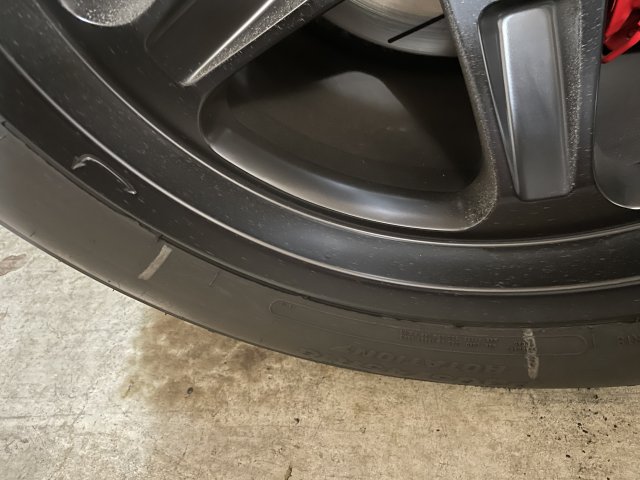

I use hi- tack
They move some first time
This was after 4 passes with some sticky stuff on my beads after thorough cleaning. I have tried a few things, and they always move and get out of balance at the track.
I run about 18 lbs of air and run high 1.49s-1.57s with these tall tires. My stock tires used to move (the drag radials) but not as much, and I pulled mid 1.4s all day with them.
