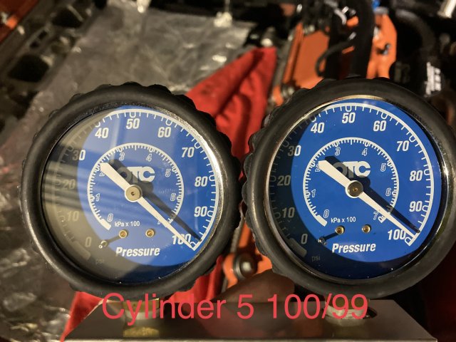

I have a compressor to so. I just don't have the tool to test. I see harbor freight has one for $70 but I'm not sure how much I would trust that. I have to have a friend with one.
Edit friend down the road has one
Your going to need a compressor a bit bigger then those little pancake ones like the 99$ Harbor Freight one, I tried mine because I didn’t want to fire up the big one but the little one would not keep up and give a stable inlet pressure long enough to get a good and accurate reading, especially if your having more then 2-3% leak down. Stock Hellcat engines are built tight, mine when it was happy had only 1/2% leak down per cylinder, 100 in 99.5 out. It is one of the things that kill them when pushed beyond factory HP levels especially if you rattle them knocking, stock ring gap is around .014-.020 and when you rattle them the rings unseat and you now blow by super hot combustion gases which heat the rings up even more and they butt and get even tighter in the cylinders and get even hotter expand and pop the weakest part of the piston out which is around the valve reliefs and the ring face delaminates and losses seal and runaway train from there. See the slight blips of Kr in the midrange? It would not go away after the -14 degrees of Kr that resulted from not using octane booster one tank for tuning purposes, only happened once, I felt it and heard it and got out of it but the damage happens in a second at 4-5000 rpm’s. C821F3F4-D395-4432-8CE7-BCA5EE6ABFAB.jpeg B9DD2D46-B97A-4A92-9ADB-EE370A990A57.jpeg 959A0D97-C5C2-438B-AE54-805EE1D57000.jpeg F7C693BF-26ED-4648-BAE7-70684B988931.jpeg 1C447E69-0248-4719-97B2-444B8B7A020B.jpeg 9854CDEB-AB91-443C-84AF-54981838CAD0.jpeg 67A865A5-F49B-450D-948E-EDD15DA51E56.jpeg BA347255-0EBA-4726-A179-655A3BBFA19A.jpeg 41E299BE-F8E2-43C7-A683-949C94155D86.jpeg 880FF175-92BE-4E16-AF72-388356441A2E.jpeg
