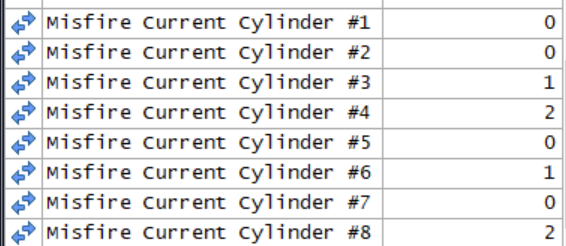

I shared this on the other forum in the D170 spark plug thread. This was after two WOT pulls on E67 4-6 gears. As you can see mine is not seeing any misfire problems which have been reported by some and I'm wondering what's up.....bad fuel, bad plugs, internet rumors, dunno.

Those plugs are typical of what happens with too much boost and timing for the fuel octane being fed to the engine. ie what @Speedy was saying he was seeing in logs running 93 with his 170.
Just because the PCM is programmed/tuned to remove timing when it’s seeing knock i.e. detonation, doesn’t mean it’s going to be able to remove enough advance and quick enough to prevent a cylinder meltdown which spark plugs like that are indicative of. I’m sure if he would’ve done a leak down test probably had a blow by issues past the rings as well, and possibly exhaust valve leakage issues from the pieces of spark plug ground strap possibly getting caught in the seat of the valve. That’s sad for a new car :(

lean would turn into a miss after the plug tips where gone, like pictured lol
