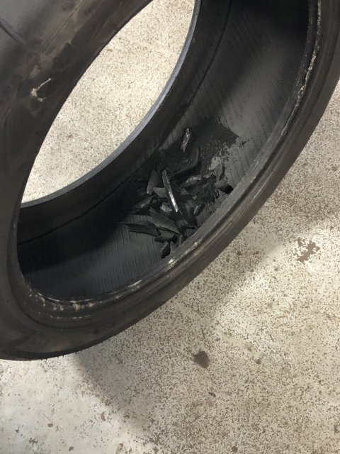

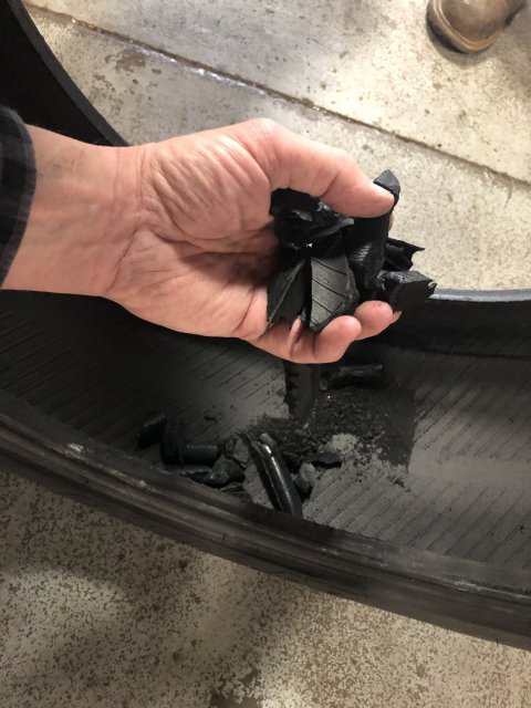

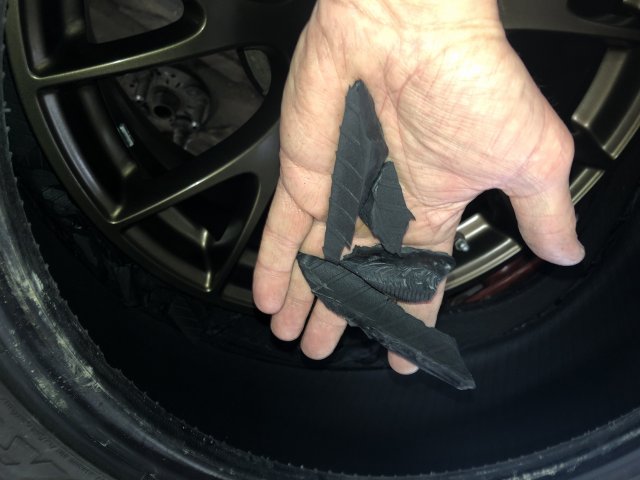

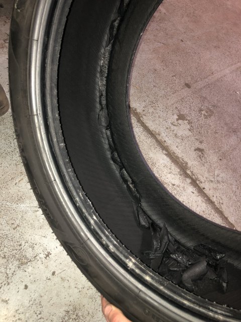

Any issues on the inside of the tire?
Funny mine did this on the inside edge as well, WAAAAYYY worse though as the damage was hidden from view inside the tire. Only knew something was up from an occasional shake in the front end and in changing the oil with car jacked up spun the tires only to hear something inside one, I thought it was the TPMS sensor broke loose, boy was I wrong, lucky to not have a blow out in a 180 mph run just a few nights prior
View attachment 17107 View attachment 17108 View attachment 17109 View attachment 17110 View attachment 17111
I saw this in the original post. Still scares the living sh^& out of me. I may follow @DGatzby 's advice and go with Michelins or the DWS06 Conti's @Piening2150 suggests even though the Pirelli's have less than a 1000mi. I know those were some no-name brand that came on the car, but when your talking front tires on cars that weigh like these and have monstrous power and speed, you need top notch goods on front rollers. The Michelin's and Conti's seem to have nothing but good things said about them from people who use them.
Wow. I'm amazed that the tire held air with the liner that severely damaged.
Never needed air EVER, Was at 32 psi cold and 34-35 hot always, even with digital gauge.

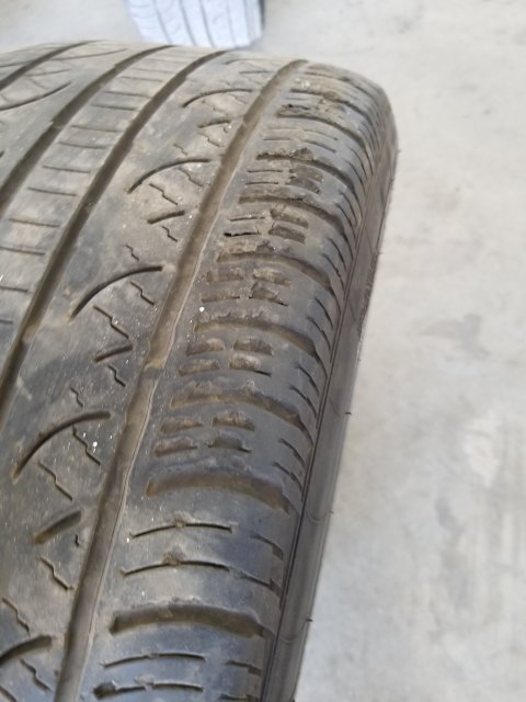

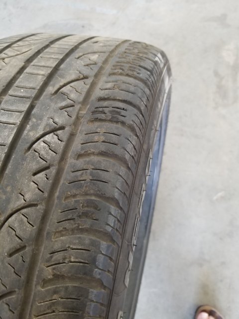

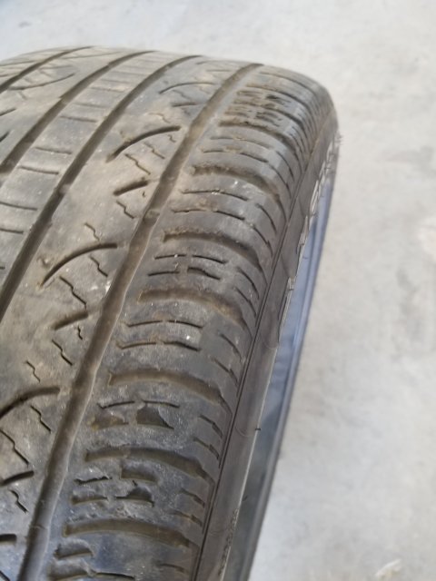

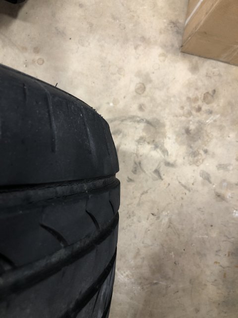

Shot of one of the OEMs with the inside wear / chunks missing.
4,902
19,626
That's just bizarre, you sure the alignment is at spec ?
20,163
Thread Starter #37
Perfectly on, the dot. Checked multiple times over the last three years at multiple locations. I've never seen anything like it, but as I noted above, my tire guy has seen that on his personal Corvettes.
EDIT, those are late model corvettes, not the C8 though.
