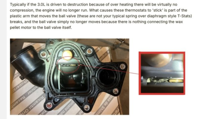

The culprit is the ball thermostat design. There was a part revision for 2025.
We got a 2025 Wagoneer Overland, and the 3.0L Standard Output is lively with the 4x4.
There are a couple of bolt-on tuners in the aftermarket; however, I don't think it's worth adding heat to a turbocharged engine.
3.0L High Output version (the same engine in the upcoming 2026 Charger 6-pack) runs 26 psi vs. Standard Output 3.0L runs 22 psi.
Most issues have been with the 3.0L High Output, and some have been with the Standard Output.
