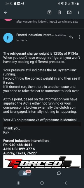

Yea. I changed out the compressor, drier, and expansion valve. Charged it with 1200g. It worked about half way if that makes sense. Certainly cooling but not like it was. Pressures were 80 low side. 150 high side. I might go ahead and buy a pressure switch as well. Im unsure whether itd work "half way" if it was bad but at this point im lost.
I know it was working before and the only thing in the area i was working is the pressure switch and where i extendes it for the chiller. Ive looked these areas over extensively and checked what HP tuners sees. See above pics. Got a guy looking it over as well. Will post back when i find something. Once i get it up and running ill update my build thread with the whipple and new tank and cwa. Its a sweet setup.
1200grams is way too much (42ounces) i agree with @16GoManGoHC2 slowly bleed the system and see if the low side drops ,,i personally start with 24 onces on mine then i bleed it to where its reading 35 on the low side ,i also have a big fan blowing at the front of my car ...i have a chiller as well no way they hold 42 onces ,,stop throwing parts and money at it ,,go back to the basics

Was just following what Kirk from FI saod

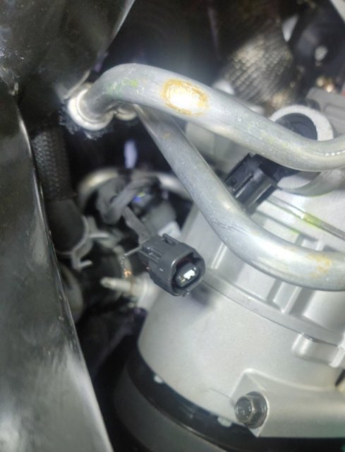

Well i found the culprit. Sensor on back side of ac compressor. Mustve been internally broken. When i was messing around double checking all my lines it just fell out.

I did it. Im not sure what that person is talking about.
All is well. Will update my build thread soon.
