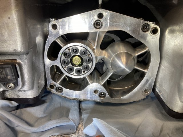

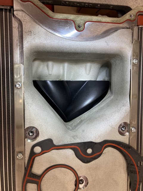

If whatever CC regardless of mounting location is not doing the job, you will see residue inside the snout, looking through the TB. Mine is mounted with a clamp to the SC lid & the inside of the snout is clean & the CC is collecting oil.

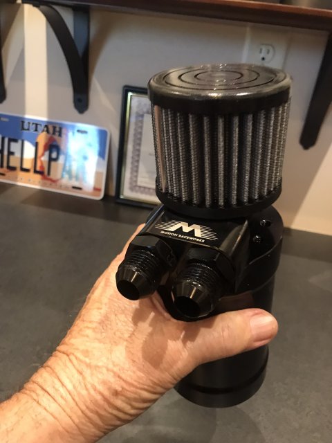

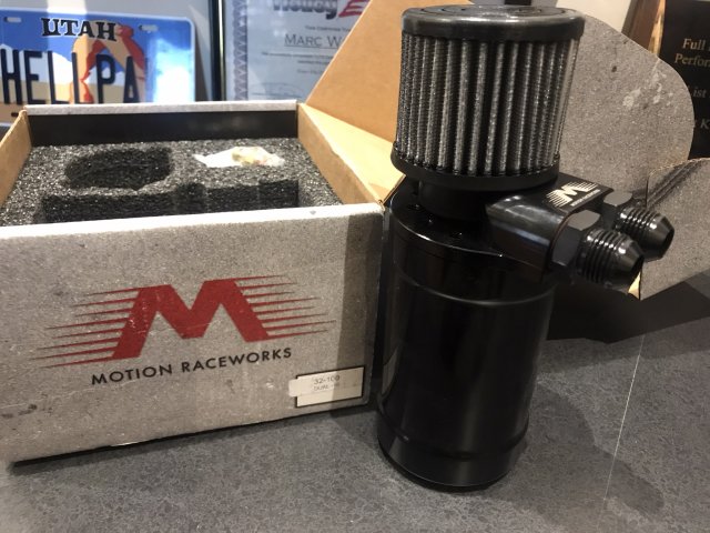

. A properly designed catch can will relieve crankcase pressure and capture all oil vapor being released with that pressure with no return into the intake. That looks like this….. -10 lines (one from each valve cover) thru properly designed baffles that condense and contain the oil and fuel vapors and relieve the pressure thru the top (filter). It is located away from the heat. This accomplishes two important things. Crankcase pressure is a bad thing. It gets rid of it. Oil in the intake/combustion is a bad thing. It gets rid of it. 12D6C906-FEDF-4A88-A84D-D2F623FB1348.jpeg 5CF72B4C-41C0-4930-A8C1-9D2075064FF4.jpeg
Same, this was intake of my blower when recently apart for coupling issue, inside of lid above blower outlet clean as well. 3257BB1F-81F9-4354-979D-448A03082AD4.jpeg C46ED27B-0454-4C46-8E1C-A6F81D283595.jpeg

Wow spotless 👍
