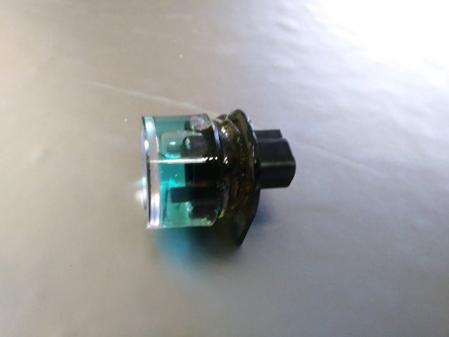

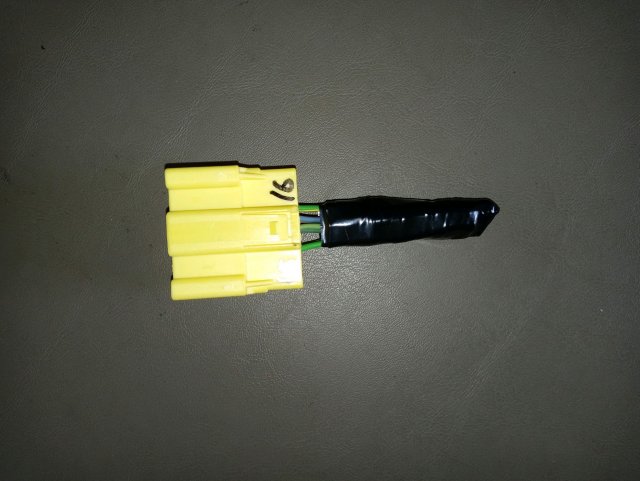

srtdusty has been very helpful with feedback and testing these. So, what we discovered is that I am able to fool the Pass side with all resistors. No buckle needed. The car is happy with resistors where the buckle is. So with the Pass only all resistors you will not have an airbag light and you will not have a seat belt light once you buckle the drivers side seat belt. BUT : I have not and probably never will be able to fool the drivers side seat belt. Because there is a difference in what the car wants. For the passenger side the bypass is making the car think there is an unoccupied seat and can be fooled with resistors. For the drivers side the car wants to see a "buckled seat belt". The difference is the drivers side does NOT have an occupancy sensor. A person present in the drivers seat is assumed. Duh! The buckle has a Hall Effect sensor and it cannot be fooled with resistors. As far as I know the Module in the car applies a voltage on the buckle circut and is looking for feedback of some sort. Also polarity on the actual buckle circut does matter. So, another thing that can go wrong.
srtdusty's second set going out (this set should take care of the seat belt light from the drivers side) and one other members set just finished.
ok I’ve received the second set and have tested them. Here are the test procedures I used. I did take pictures of the dash with each step if someone really needs them.
step 1. started the car with all factory “setting”. drivers seatbelt fastened = no lights
step 2 Unplugged the yellow connector from both seats, started the car and the airbag/seatbelt lights with service airbag system message.
step 3. Plugged drivers seat factory connector back in with passenger seat bypass harness connected = no airbag light with seatbelt light on. Fastened drivers seatbelt and seatbelt light went out.
step 4. Unplugged factory drivers seat and plugged in bypass harness with the supplied buckle out = no airbag light. Seatbelt light on.
step 5. inserted the supplied buckle and the seatbelt light went out.
step 6. Removed bypass harness’ and reconnected the factory connectors started the car with seatbelt fastened = all lights went out

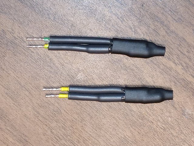

I took the info that Pete posted in the other forum and info I learned from members buying full on Hellcat Harnesses for me to cut apart and learn from, and now I can now make bypass harnesses for 2015 - 2019 both Pass and Drivers side. I am now making them with all resistors. No seat belt buckle needed anymore. So, they are cheaper to build and more compact. I also make the Windshield Washer Bottle level foolers if someone wants one of those. All this does is make the AirBag light in the dash go out. So, if you are like me and do not like warning lights on. The main reason I got involved in this is because you may not pass Tech at some tracks with your AirBag light on and my Friends and Forum Members were asking me to make them. My local track, Irwindale, will not let you race with the AirBag light on.
I also will help ANYONE with the info needed if you want to make your own. Keep in mind, you need to buy an OEM harness to cut apart (Pete was right, it's much cheaper than the repair kit) , resistors, heat shrink, tape, solder etc.... View attachment 6167 View attachment 6168
