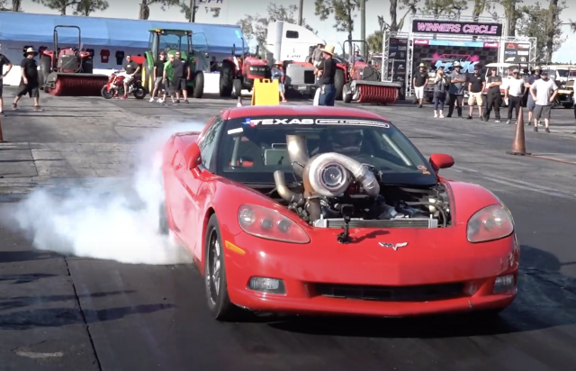

Ya'all are killing me...
2.85 on E85 and I've got the life vest on...
What's it going to take, a 10% lower and a 2.5" upper, E85, N2O, Meth and a monkey pushing in the trunk???
o_O
You don't necessarily need the meth, silly.
The monkey for sure is a must have.😂🤣
