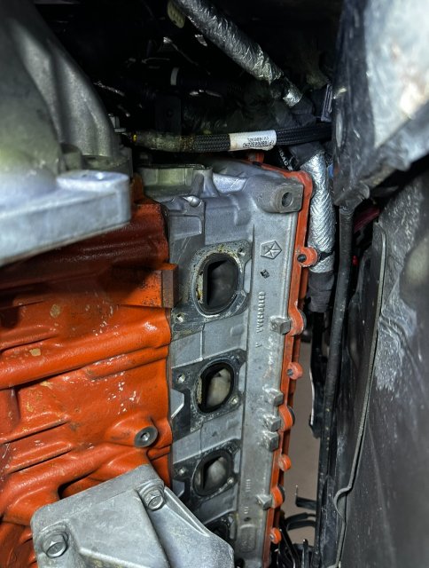

Thread Starter #84
Passenger side completely out. 2 bolts left on driver side. Going to be a pain due to my chiller refrigerant lines

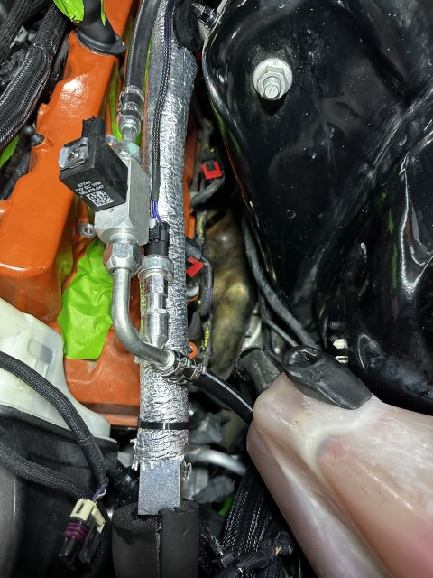

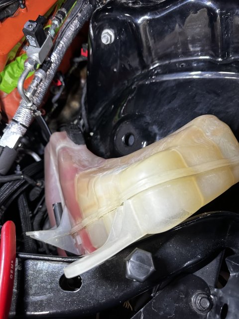

Thread Starter #89
Still a pita with chiller lines, but not much worst that stock. This gives you a lot more room (still a pitta)

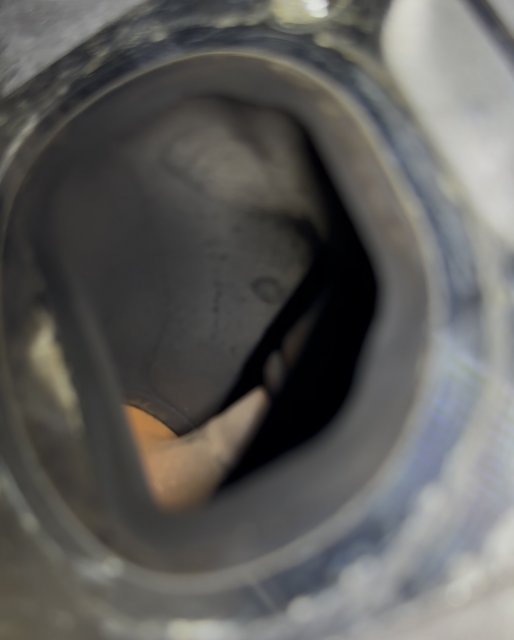

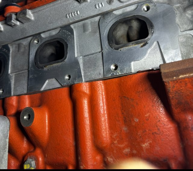

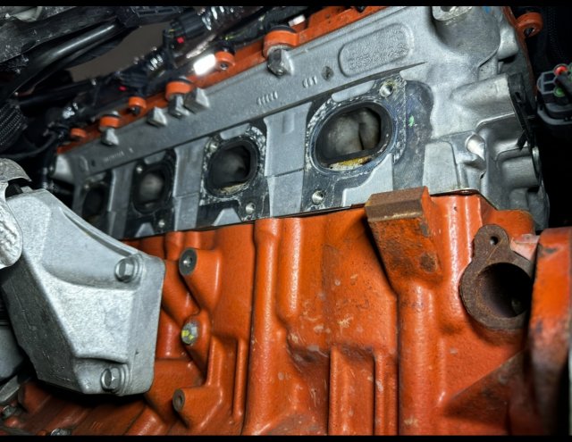

Thread Starter #90
Ports could be worse. Tops of the valves are orange.

Thread Starter #91
really nothing to clean off of the heads. Suggestions? Brake cleaner and a cloth?

Thread Starter #93
Going to try and pick up some red scotch brite tomorrow, maybe get them hung on the bottom bolts Christmas Eve 😆. Thanks @fumanchu182, appreciate it

Thread Starter #97
Welp slow and extremely light and scorch brite left small scratches in the mating surface in the heads. A bit weary since it’s a metal to metal seal
2ndgen
#1309
418
664
Orem
#98
Might need a light coat of RTV to make sure it seals.
U
8,659
7,634
Thread Starter #99
I’m getting it off but I don’t want to keep going over it, especially since I can only go over pretty much 1 at a time. Don’t to create low spots. I have more off now than in this pic in those 2. I think rtf might lead to more problems, not sure 🤔
