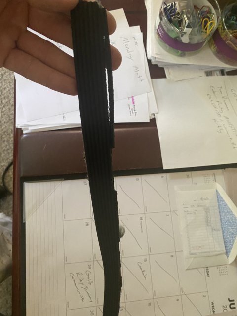

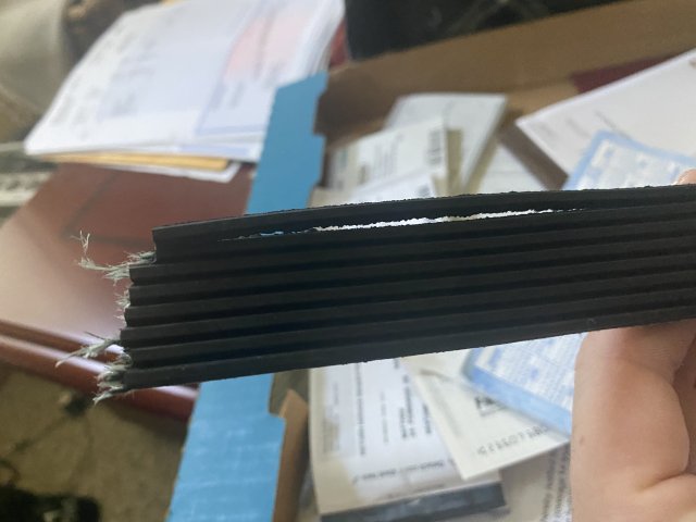

Definitely don’t want to compound a simple 30-40 dollar belt failure to a 15-20k supercharger issue. I remember thinking watching that mod to fame video what an idiot when he blew it. I can’t be that same idiot!
3,501
11,270
It may just be the pictures but it looks like your belt lost some ribs before the failure. How many ribs does that belt have? If it’s less then 10, then there’s your problem. If you have a tensioner or idler failure, it can allow or even force the belt to walk off the drive pulleys and it will start trimming the ribs off. Make sure to check your tensioner because those have been known to fail. If the spring is broken, it will not keep proper tension on the belt when you pull off the gas or on shifts and allow it to jump off the pulley.
Maybe the spring broke? Sounds possible
Hmm E26F3726-D703-44B5-9AC5-6CD24FE4337D.jpeg my belt only had 8 ribs for the green, it looks like it just caught the outside front rib and trimmed it off B45D4F01-C139-42F9-8633-8E4236F03169.jpeg
3,501
11,270
Hmm View attachment 47885 my belt only had 8 ribs for the green, it looks like it just caught the outside front rib and trimmed it off View attachment 47886
That means that the belt walked sideways on the pulley and the outside edge of the pulley trimmed a couple ribs off, weakening the belt. That most likely happened because your tensioner didn’t do its job. You probably aren’t pulling the kind of boost I am but I’ve encountered the same thing. I had to address it by going to the billet tensioner with the heavy spring in it. The spring in the stock tensioner wasn’t strong enough to keep the necessary tension on the belt. The other thing you want to check is the guide pulleys that have bearings in them (tensioner and idler). The bearings go wobbly and it can steer the belt off the supercharger pulley.
Yes it was sideways before I took it off Marc
