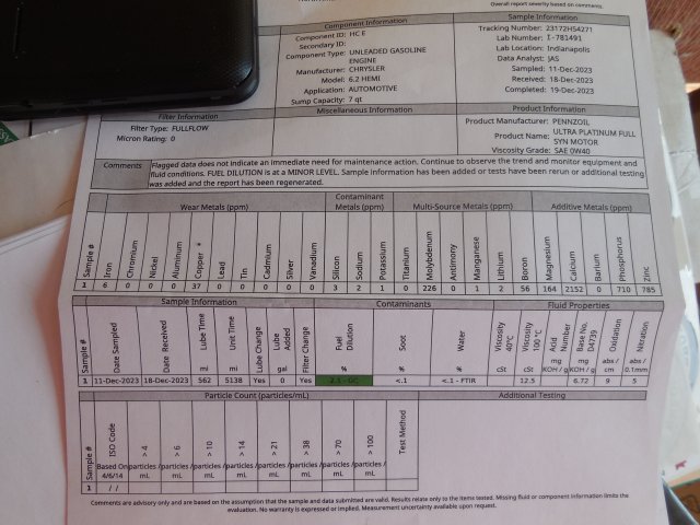

I would imagine that the reports look quite similar. It's how the two labs arrive at their data that differs.
There's one important number that Blackstone supposedly uses some formula to arrive at, rather than actual analysis results. Similar to Ram's algorithms for oil pressure rather than real oil pressure readings, I suppose.
People who know far more about this stuff than I do (like the guy who "analyzed" this analysis for me) won't use Blackstone since their reports apparently don't tell the whole story.
Does it matter to someone like me? No, because I wouldn't know how to completely interpret the results anyway. But in this particular case we definitely wanted to know as much as possible when testing 2-year old oil in two 'Cats with basically identical mileage and time on their oil.
And, for about the same cost, given the choice I prefer the batter analysis no matter what. DSCN5421[1].JPG

Comments tell you nothing. So much for an analysis of the data, looks like they just send you the data and say you analyze it

Well, it's easy enough to find out what ppm of what would be the norm for an engine.
And the idea is not so much to see only the current results but see trends as more samples are taken. But obviously it'll only take one sample to see if there's something unusual that needs attention.
Saved me a lot of money when taking a sample on a new to me engine and there was coolant in the oil, for example.

The lack of commentary is why I stopped using Oil Analyzers and moved to Blackstone. You can also call Blackstone and get a savvy person on the phone quick when needed.
Not sure what they should've commented on, other than the comment that's on the report, when it's a near perfect sample. And the first one.
Besides, something got lost in the translation of the paperwork I sent Amsoil, so they commented on that they couldn't provide meaningful results in the original report because of the missing info. I called, and they redid the report with the new and needed info. Very helpful and nice people, I thought.

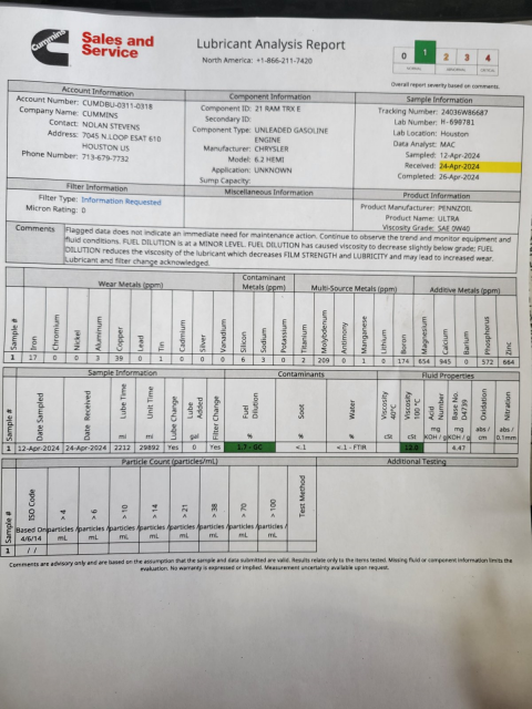

Here's somebody else's report, same engine, different application.
More comments, because the fuel dilution was starting to affect the oil. Just like it should be, I think. 1714512765439.png

Interesting about the fuel dilution in the oil. Like with e85 living in a cold climate and washing the cylinders during cold startups 🤔🤔🤔

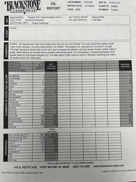

Finally got this done. Pretty good I suppose.
