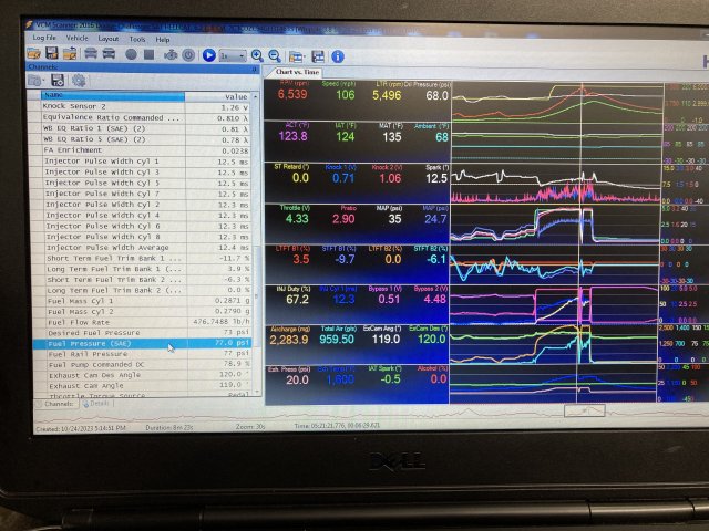

So far 2 295’s on the KB BAP are keeping up, injector DC has not hit 70% yet, Fuel pressure staying above 75 psi setpoint to where pump DC has yet to reach 80% even. Full pulls 1-2-3-4 to 150 mph last night netted the same.
You don’t think a third 285 running Full bore along the 2 295’s will equal the 2 295’s running on the dual KB BAP?

I've never run a bap so I cant really speak on them. but it sounds like that bap is saving you big time. almost like your 2 295's with a bap are out flowing my 3 295's.

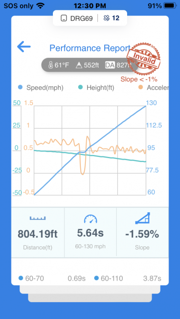

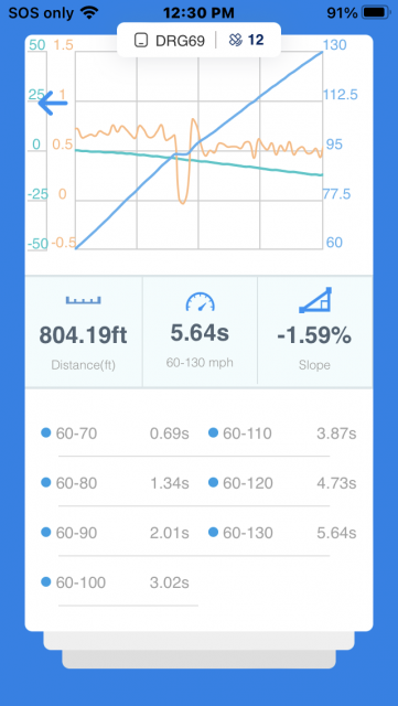

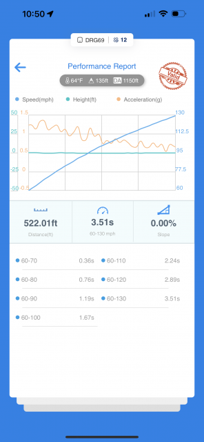

Did a 60-130 pull last night, traction SUCKED, had to leave my underwear by the side of the road after the run lol
Yes, a bit of a down hill slope but only 8-10 degrees of max timing commanded and traction control took it away as fast as it dialed back in
DA and temp on top. Not my best run but based on cold road traction it’s all I was getting lol
