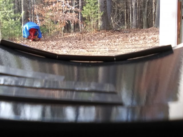

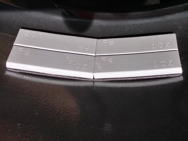

Just had the DR's balanced, they used 1oz weights, they only touch at the ends. I don't like the way this looks, I figure I'll pull them off and replace them wit 1/4's. Just wondering if the real racers out there think I'm doing the right thing.

never seen any that big. They not know the wheels are round:unsure:
I would replace them with 1/4 and find a different shop in the future

He can use a rubber mallet and then cover with duct tape until he gets them redone.

The weights are steel, the wheel might very well yield before the weight.

This was the "good" shop, these were the guys that saved me after the "bad" shop f'd them up. Minor thing to swap to 1/4's, thanks.
