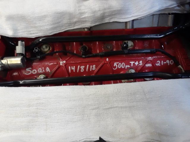

Got some pictures of my Mexican builders' messages on the block now. Either Soria built mine, or she is someone's girl friend! But the car now has a new name, I been calling it Freebird, no wonder the thing up chucked!
The blades were turning, but the pulley is definitely fried. What a shame, FCA goes for the entire unit. We have one in bound tomorrow, express delivery.
At least they apologized

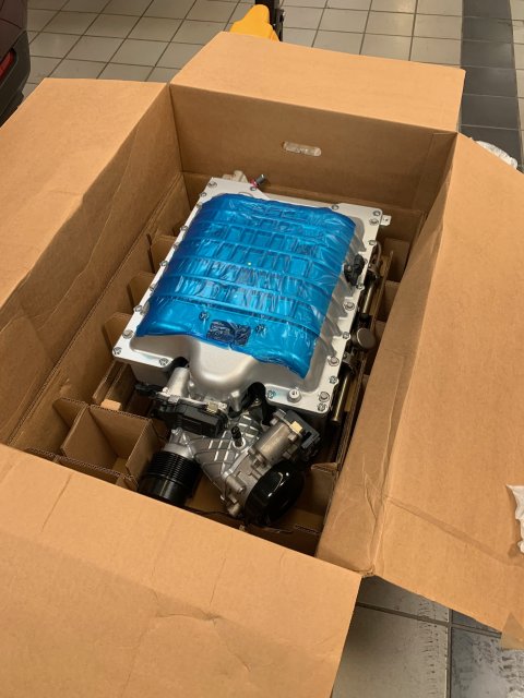

Oh it more than crossed my mind. I was feeling them out yesterday. I don't even think I could slip in a black belt (which I own now). What was wild was I visited at about 11:30. The package just arrived. Yes, the tear at the emblem was me, as I confirmed they ordered the correct size. Shot this picture...
That dude must have ate wrenches and hose clamps for lunch, and it must have went real well going back together; at 1:38pm, I got a text message my car was done! The spraying coolant in Track Mode is still a mystery, so yours truly will be visiting them this morning. That car and me are going to have a moment or two in Mexico while I confirm it will take my right foot without shitting all over itself. When I asked the Advisor if it was really done, the response in email was: "the supercharger boost came in perfectly, and he said it had the appropriate outrageous power you would expect". Fluid levels were checked, he personally told me he would pressure test the sc coolant circuit. Interesting morning coming up. I brought it in on the 305/35 Toyo R888R's with the black wheels, I bet someone crapped when it probably lit them nearly on fire in a low speed road test to confirm sc function!
