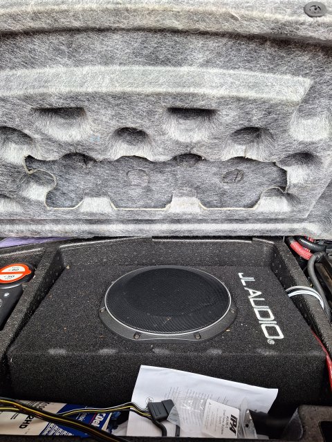

@Scatpack2023 I cannot speak to the difference in trunk trays between your car and my charger. I do know that I elected not to trim the tray at all and instead cut a recess into the lid that fits down over the spare tire area. I only notched one edge of the foam low enough for the wires to pass over and down into the box.
It looks like after 5 years give or take that I could have actually extended that cut about another quarter inch or so toward the rear bumper as you can just begin to see the depressions on the carpet of the box.
Also... looks like i dented the speaker Grill at some point. I don't know if that is from the edge of the cut or if it's from me ham fisting it like a potato. Another quarter inch in both directions from my cut and it probably would have never made contact if that's the case
View attachment 136491 View attachment 136492
Hello fubar569,
Thanks for the extra pictures and clarification! Five years use and still going well says alot for the JL Audio self powered subs reliability and issue less function in this application.
From everything I've seen, the same part number foam liner is used in all models Challenger, Charger and Chrysler 300. The number has superceeded several times but I don't know if there are any real or slight differences between any of the different number foam liners.
Studying the pictures from AV8ing1 posts and me test fitting this sub into my foam liner, it really seems that some of the lower floor of the foam must have been removed or cut out in an area completely to allow the sub to sit in the foam that deep. I do like the way he cut the hole in the side of the foam for the wires and to allow adjustments.
Wishing for a response from AV8ing1 to confirm foam liner modification before we begin cutting on it.
