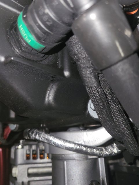

None of those photos show the wear indicator
See the last photo,that is the tensioner.It appears loose not in the middle.
7,471
19,633
The tensioner has a range of movement and theres a marker. That marker should be close to center of the range. That's what I'm asking about. I don't see it in your pics.

The tensioner on the 22 Redeye is a different design.If you look at my first post. There are 5 photos, the tensioner is the last photo down.It does appear loose. It is not in the middle.Below photo shows the top of tensioner where the marker would be on the previous tensioners.

Looking at the front edge of your belt in pics 1 & 4 it looks like it’s fraying a bit. Leads me to believe it’s not tracking straight and rubbing the edge of the pulley which would explain some of the dust. Of course slipping due to it being loose would also cause dust.

The photos seem to make the edge of the belt look worse than it is. It seems to Line up on the pulley well. I have 3 different belts Ordered. We'll see what happens.
